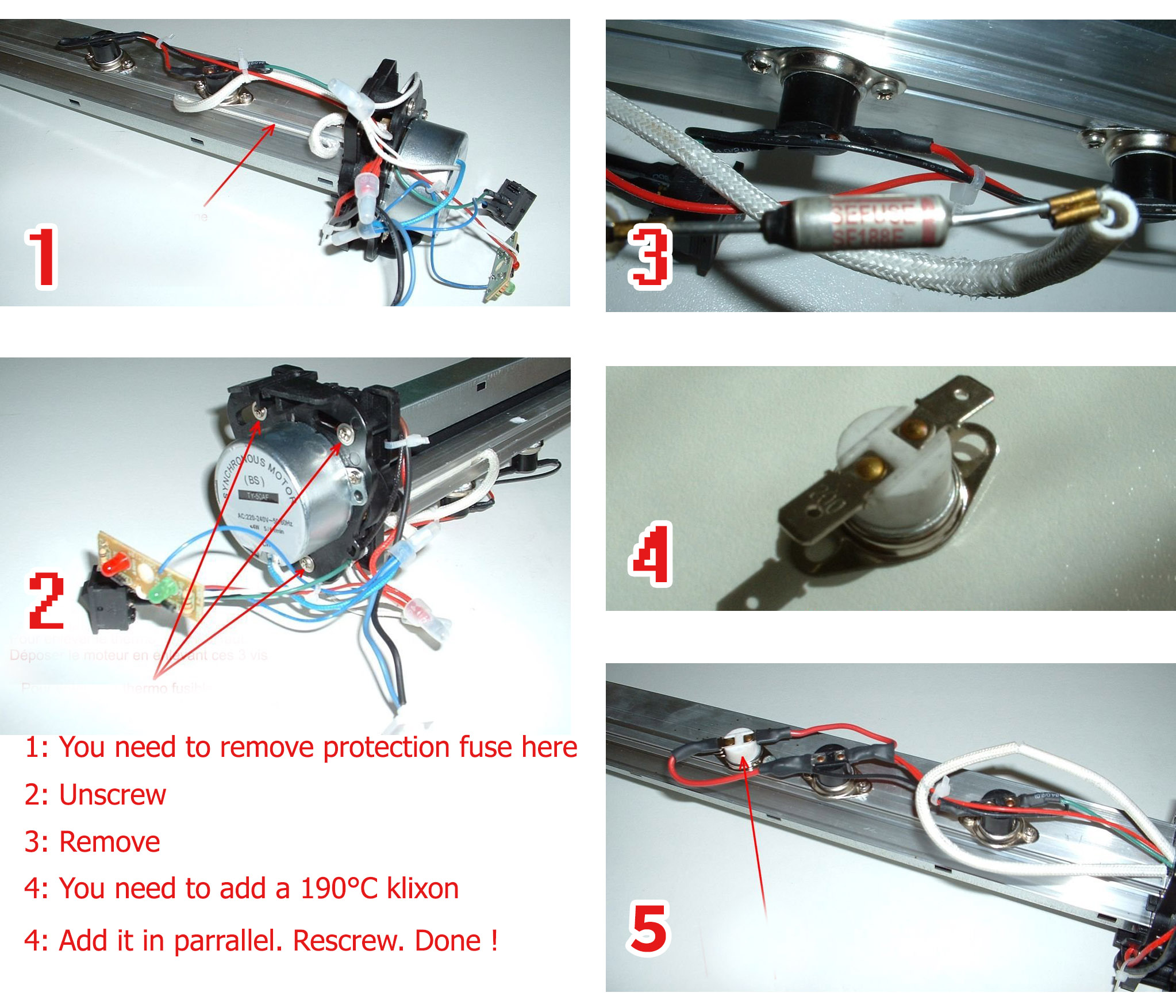

A Simple and costless method Flow to make proto PCB based upon Laser Printed Negative and Laminator or Ironer.
The laminator need a hack to increase heating temperature , but it's a more precise way ta make the transfer than ironer.

Laminator Transfer
Laminator hack
