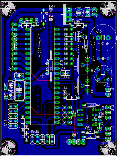

See also the schematic of the MBHP_CORE module as reference, or this PCB layout:
