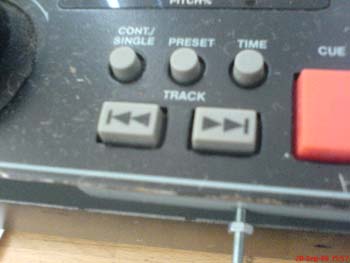

This is Wild_Weasel little Midibox Traktor section.This is again a denon remote control unit retrofit, namely a RC-35 MK III for the DENON DN-2000F MK III cd-player unit.
The unit was bought at ebay for approximately 50€. After testing the player, which still worked, I ripped it apart.

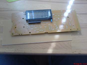

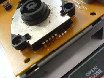

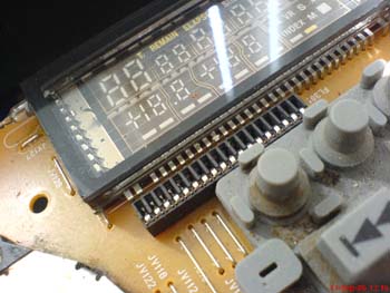

After that I desoldered the PCB to have a template for making new ones. This was done with the help of a desoldering pump. The pushbuttons, the leds and the jog/shuttle wheel have been desoldered.

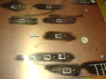

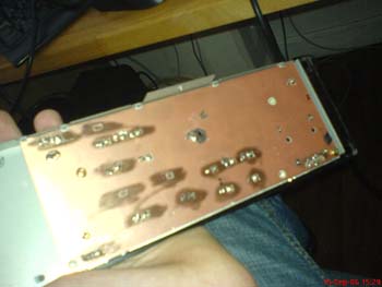

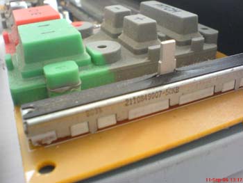

Afterwards I milled new soldering pads using my dremel tool again. One pin from each pushbutton is insulated from the rest of the board (which acts as ground) this way.
stud3.tuwien.ac.at_e0327352_midibox_denon_20mb_202_dsc00295.jpg stud3.tuwien.ac.at_e0327352_midibox_denon_20mb_202_dsc00296.jpg

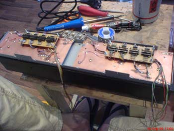

Mounting the parts and attaching cables.
stud3.tuwien.ac.at_e0327352_midibox_denon_20mb_202_dsc00298.jpg stud3.tuwien.ac.at_e0327352_midibox_denon_20mb_202_dsc00299.jpg

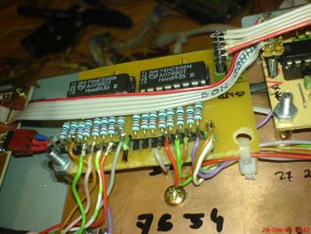

A DIN X4 is piggybacked to each board with M3 srews and spacers.
stud3.tuwien.ac.at_e0327352_midibox_denon_20mb_202_dsc00300.jpg stud3.tuwien.ac.at_e0327352_midibox_denon_20mb_202_dsc00301.jpg

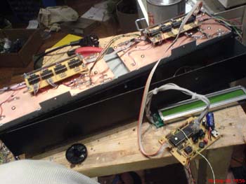

First test with a core modul attached.
stud3.tuwien.ac.at_e0327352_midibox_denon_20mb_202_dsc00303.jpg stud3.tuwien.ac.at_e0327352_midibox_denon_20mb_202_dsc00306.jpg

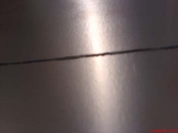

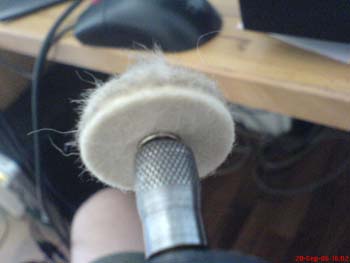

Scuffing the silkscreening away
stud3.tuwien.ac.at_e0327352_midibox_denon_20mb_202_201_dsc00307.jpg stud3.tuwien.ac.at_e0327352_midibox_denon_20mb_202_201_dsc00309.jpg
DOUT module installed. Even works with high power blue and white LEDs.

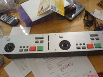

Welding and soldering additional sheet metal to cover the display cutouts.
Partly finished after bondoing and sanding.
Update 13.2.2007
I added 8 Encoders for FX controll. Turning left/right increases/decreases the value. Pushing the Encodes activates/ deactivates the FX-Button in Traktor. Pushing the outermost encoder with the shift-button engaged changes the selected FX in Traktor.
