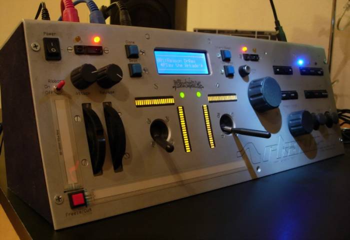

Arkade is a MIDI controller that embeds pairs of everything :-o :
  • A pair of analog joysticks coming from a canibalized PS2 gamepad ^_^. They center when you release them (+ they're rock solid !)
  • A pair of standard analog joysticks (positions doesn't change when released)
  • A pair of infra-red distance sensors, a pair of ribbon controllers
  • A pair of wheels (modulation, bend) coming from my died DX7s
  • A pair of knobs
  • Midi In / Out + sustain / expression / switch pedal
Sustain, expression, and switch pedal inputs; MIDI In/Out, power

Assembly
  • 1x core, 1x AIN, 1x DIN, 2x DOUT (one is 100% dedicated to the joystick's bargraphs)
  • 1x bankstick module filled up with 8 chips
  • 1x standard LCD 20×4
  • 2x Sharp GP2D120 infra-red sensors
  • a PS2 game pad … sure you have one somewhere 8-)
  • 2x analog joysticks, 2 pots, a set of wheels
  • well … all the other sensors already mentioned

  • Soldering the bargraphs was a piece of a Hell … so many cables, so few space !
  • Adapting some of the sensors to the MBHP platform needed some conditionning (use of caps, resistors, many values were tried to find the right ones). The response curve of Sharp's IR distance sensors is logarithmic; I've linearized them in a software manner but you could also find a way to have hardware linearization (I'm interrested by the diagram if you find this 8-)). Anyway, the software linearization doesn't require that much CPU and they're still very reactive ;-). I'll post some of the sensor conditionning tips (components & values) later on.
  • The ability to update the OS on the machine in a single click (thanks to MIOS Studio) just rocked
  • Special thank to my friend who could directly put my Autocad file in his drilling machine at his work to build the frontpanel
    • → for those who plan to ask me who's this guy I have to say it was a one shot work; he doesn't plan to make it an industry :-\
