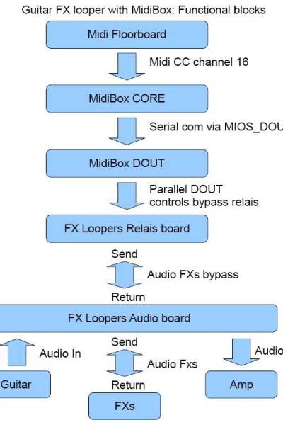

Architecture
Hardware

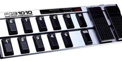

External Controller Midi Floorboard
Use the Behringer FCB1010 floorboard that sends one Midi message when pressing down a knob-controller.
MidiBox
Use the MidiBox as controller that recieves the Midi messages and controls the true bypass switches: www.ucapps.de
MidiBox kits: www.mikes-elektronikseite.de
I need a:
- CORE Module, that I can program to receive the midi from the footcontroller and translate midi program changes into on-off digital signal outputs.
http://www.ucapps.de/index.html?page=mios_c_set_dout.html
- DOUT Module, the digital outputs that will be set by the CORE module and will control the FX loopers.
NOTE: When using only 7 FX loopers, DOUT can be omitted. The FX looper board then needs to be connected directly to a CORE header. The application then needs to drive that header directly. This is not yet supported but should be relatively simple.
- PIC18F4620 (with the bootloader)
- OPTIONAL: LC Display 16×2 with backlight (for developing/debugging/testing purposes only, final version does not need a UserInterface)
User Interface: Keep it simple
Try to avoid or minimise a user interface so I would not need a DIN module nor a frontpanel with knobs and stuff.
Indicator LEDs
It would be nice to add indicator LEDs for the FX loopers so you can see which FXs are bypassed (=LED OFF) and which ones are enabled (=LED ON).
The indicator LEDs are also driven by the Relay driver chip.
LED ON ⇒ FX is not bypassed so it is in the FX chain.
LED OFF ⇒ FX is bypassed so it is not in the FX chain.
Using DPDT Relays
Use a DPDT relay for bypass switching 1 FX:
DPDT relay switch board, controlled by the MidiBox DOUT module.
Each of these DPDT relays will bypass or enable one FX.
Drive the relay with a ULN2803, 8 relay driver, chip.
Perhaps add circuitry to remove clicks / pops induced by the relay into the audio path.
