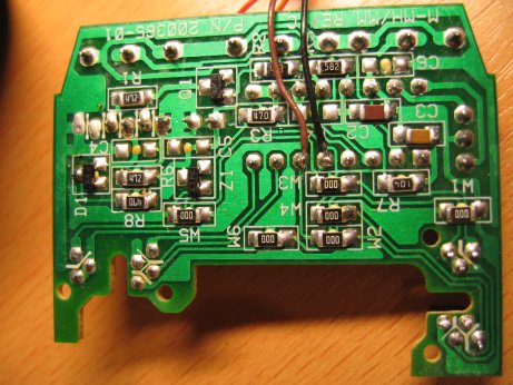

On the other side of the PCB you need to solder the two cables that will receive the signals from the phototransistors, as shown on the picture below. This will let you use the encoder that's on the left on the picture above (on the right on the picture below).
If you want to use the other encoder, you'll need to connect two more cables next to the brown and black cables, at their left (not tested yet).
On the DIN board, you'll need to remove the pull-ups resistors, because the phototransistors signals cables already output a stable voltage (either 0V or approx. 5V). I haven't tested with the pull-ups resistors on, but I think it won't work, because the mouse PCB works with very low currents.
Now connect the other ends of the cables to the DIN board as shown below. The red cable (+5V) is connected to the upper part of the resistor. It isn't very nice, but it works…
It isn't a problem if you switch the brown and black cables. It will only switch your encoder's counting (ie turning it right will increase values instead of decreasing them).
