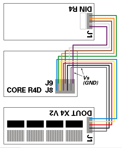

Connection to Core Module
Check the version of your Boards;
if you're using SmashTV's Core that's equipped with double rows, you can build a split-cable to connect J8/J9 to a DIN and a DOUT:
