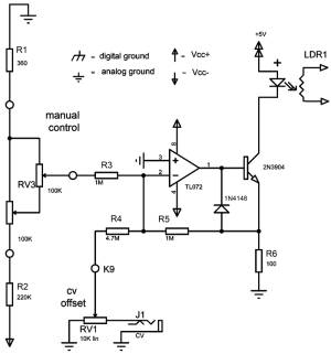

Option 1: The Vactrol
The vactrol is in essence a LDR (light dependant resistor) / LED combination in a light proof container. A control voltage can drive the LED, change its brightness and the intensity of light will vary the resistance of the LDR. would this work with PWM of the LED? DrBunsen
Circuitry on both sides can be used to scale voltages/resistance/response to a useable range. The relatively long response time this suggests maybe PWM would work! doesn’t have to be a bad thing for most applications: for instance, when you are sweeping an FX parameter .
Bridechamber - a seller of synth modules and kits, intend to offer soon a 1”x2“ vactrol based VCR as a kit or prebuilt. The size makes it suitable to directly replace a pot or resistor in circuit. Find it under “PCBs” and email them for more details.
As a starting point for our own designs I (illogik) have taken part of a schematic for a voltage controlled delay from Scott Bernardi - og2 diy modular synth. It uses a vactrol to control the delay time.
If you want to build the delay, I’ve made a sketchy but working PCB design for it in Eagle *.brd format, which I will post later this week. any news? DrB
_About the schematic:_
For now these are the resistor values that were in the original design. You should always use a yellow LED; LDR’s work best with this colour.
This design uses an op-amp which requires a bipolar supply voltage like +/-12V. You may have this already for your MIDI to CV converter. RV1 and RV3 are trimpots, although RV1 can be a front-panel pot too for setting the amount of CV input.

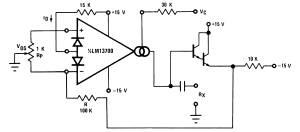

Option 3; the OTA
The OTA (operational transconductance amplifier) is an IC which is used in many VCA designs. You can use the LM13700, a dual OTA
This text and the designs are straight out of the LM13700 datasheet.
An OTA may be used to implement a Voltage Controlled Resistor. A signal voltage applied at RX generates a VIN to the LM13700 which is then multiplied by the gm of the amplifier to produce an output current, thus
Rx= R + Ra / (gm * RA)
where gm ≈ 19.2 IABC at 25°C. Note that the attenuation of VO by R and RA is necessary to maintain VIN within the linear range of the LM13700 input.
VCR with one end that must be attached to ground (uses half the IC)

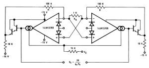

“Floating” VCR: both sides of VCR are free
A floating VCR where each “end” of the “resistor” may be at any voltage within the output voltage range of the LM13700.
Hmm, I (illogik) can’t say I really understand all this, but maybe that’s not necessary; I will build the circuits and do some experimenting. Vc is the CV input; there can be some opamp mixers befor this point to do the scaling.
