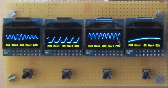

Scope Display
Up to 4 SSD1306 based “scope displays” can be connected to display CV output waveforms with a selectable oversampling rate and trigger level
