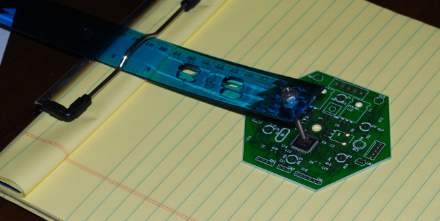

Soldering surface mount parts: There are many ways, from “wave” soldering to mask soldering, to baking them in a converted toaster oven. The biggest problem I had when hand soldering was keeping the chip in place. I could get it located perfectly, but as soon as I touch it with the tip of the iron, it would stick to the iron and all was lost. I fixed this with a simple tool anyone can make with stuff that is laying around the house. Take a ruler, or anything that resembles one, and add a small hole in one end if it's not there already. Then add a screw and a nut through the end. Find a clipboard, and use this under the clip to hold parts in place. Here's a quick picture, though I would prefer a wooden ruler. :-)
That chip will stay put easily while soldering, and the ruler puts only a LIGHT pressure on the chip, so nothing gets damaged. No, that's not a MBMixer board, those have not arrived yet. (But it is a PIC18F458, alternate core, anyone?)
