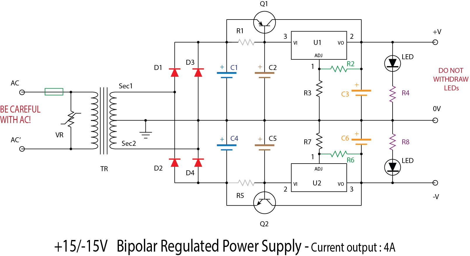

A designed has been purposed there :
Value | Type | Qty | Designation |
LM317T | VR | 1 | U1 |
LM337T | VR | 1 | U2 |
BDX54 | PNP | 1 | Q1 |
BDX53 | NPN | 1 | Q2 |
10A04 | Diode | 4 | D1,D2,D3,D4 |
10 | Resistor | 2 | R1,R5 |
120 | Resistor | 2 | R2,R6 |
820 | Resistor | 2 | R4,R8 |
1320(1,1k+220) | Resistor | 2 | R3,R7 |
1µF/25V | Capa Elec | 2 | C2,C5 |
22µF/25V | Capa Elec | 2 | C3,C6 |
10000µF/40V | Capa Elec | 2 | C1,C4 |
S05K400 | Varistor | 1 | VR |
15VDCx2 90VA | Transfo | 1 | TR |
For Fine Voltage Tuning replace R3/R7 by a 2K Multi turns Trimpot.
