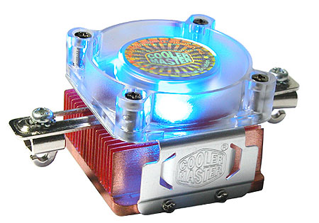

- Fan. 40mm fan. I used a fan removed from a Cooler Master Blue Ice Pro chipset fan.
However, any 40mm fan will do. I suggest Performance-PCs.com as they have a range of really cool and cheap 40mm fans with LEDs, and you can get a 40mm fan grill at the same time.
