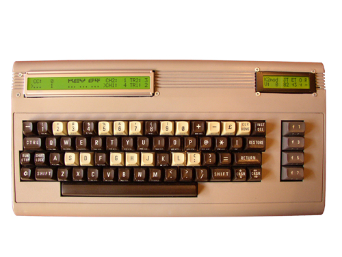

K64 Modul is seperated in 2 Applications - K64 and K2 SpeakJet Application:
K64 Application is a classic keyboard-controller to play MIDI Notes from retro C64 keyboard for seperate UPPER- and LOWER-Keyfield Input. You can control MIDI events for specific channels too. So you can use it as mobile input device for external syntheziser or to use it as input keys for SEQV3 application. With an additonal seperate SpeakJet Modul you are able to control parameters for SpeakJet and SEQV3 at same time.
If a SpeakJet-Board is installed you can use the advanced functionalities “Text To Speech” Mode. This Mode allows you to write text phrases, which are processes directly in realtime by setup variation, speed and bend for every letter of a word/sentence. Text To Speech can be controlled via incomming MIDI Notes in several modes. Every letter can be replaced by variations in Realtime. German language is pre-configured.
All Text To Speech patches can be stored up to 8 external EEPROMs on a bankstick. 2048 patches (8x32k) or 4096 patches (8x64k) are maximum possible.

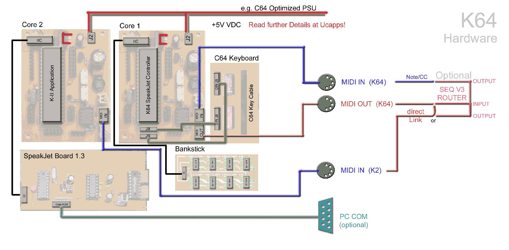

Hardware
1x Core board + PIC18F452 for K64 application v2
1x Core board + PIC18F452 for next/last release of AC's K2 (or you can use the contained 2×16 K2mod test version) speakjet_application_software_v_0.2 from audiocommander
1x SpeakJet board for the midibox_speakjet application from audiocommander
1x C64 PSU to connected Core boards with 5V DC, e.g. here: mbhp_4xsid_c64_psu_optimized.pdf
1x midiboxkb board midiboxkb_-_using_a_c64_keyboard_as_input from jambonbill
1x C64 Case + functional C64 Keyboard (older or newer case, keyboard are possible)
1x 2×40 LCD for K64 Controller application (for Key control and TextToSpeech (32 characters in 1 Patch))
1x 2×16 or 2×8 LCD for K2 application
2x MIDI-IN (on K64-Core for trigger text; on K2-Core for receiving SpeakJet commands)
1x MIDI-OUT (on K64-Core for external use (you can link it to K2-Core, but also route it through SEQV3)

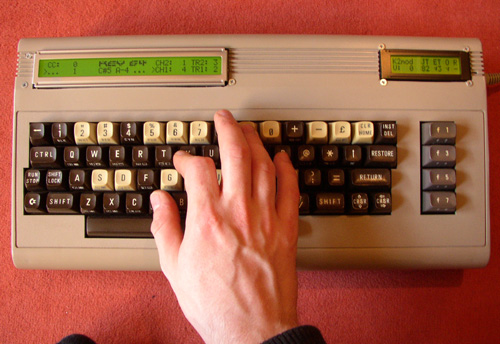

The main screen - the midi keyboard

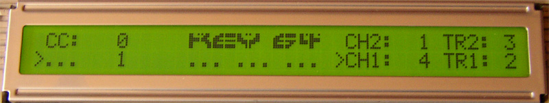

The main screen displays the adjustable midi settings to use the C64 keyboard as a splitted midikeyboard with UPPER and LOWER Keyfield. Maybe you can use it to play or control external device (SEQ, Syntheziser, K2) seperatly. I'm often using the LOWER keyfield to transpose SEQ tracks and SpeakJet pitch at same time by SEQ's internal router. Maybe the UPPER keyfield can be used for playing notes or chords directly.
Playing notes
In the middle of screen the current playing midi notes are displayed. Notice that only 3 keys are possible at the same time. That's a restriction of the keyboard matrix, because pushing a 3th key in same row/col will short-circuited some other keys in matrix. To solve that problem as good a possible, i've implemented an additional HOLD Mode (press RETURN and a “+” will be shown besides CH1). It's easier to play chords and to hold them without holding down all the keys. In HOLD Mode an additional 4th note can be played in the lower Keyfield too - so 3th chords in the upper field and e.g. a bass line in the lower field can be played and changed at same time. You can release all notes by pressing CTRL. You can switch off HOLD Mode by pressing RETURN again. The state of HOLD Mode will be stored internal.
If a played chord is known, it will be shown on the left side of note view:
Play chords / notes in a simple way:

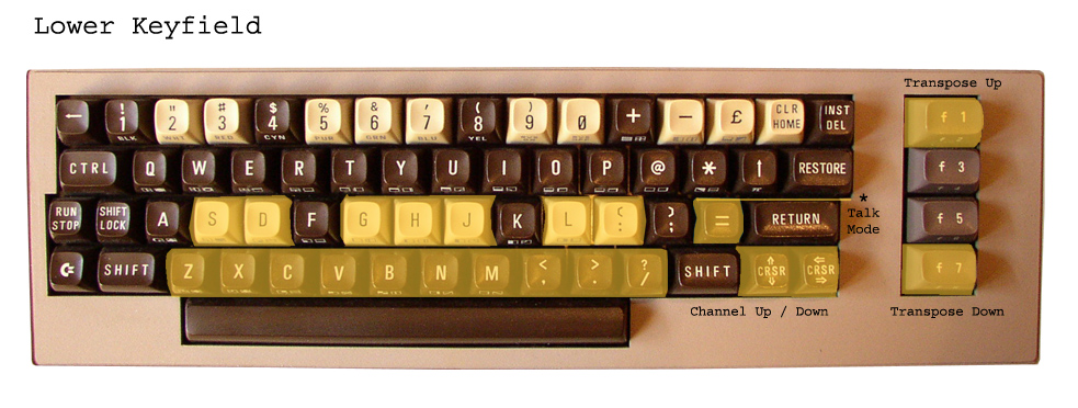

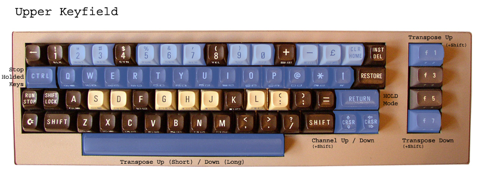

Setup keyfields
On the right side of screen the adjustable channel- and transpose-values for UPPER and LOWER keyfield are shown. CH1 (for LOWER keyfield) can be changed with CRSR keys up down, CH2 (for UPPER keyfield) is variable by + and -. Pushing F1 and F7 will change the transpose value (TR1). For the UPPER Keyfield TR2 is adjustable in 2 ways: Pushing SHIFT_R + F1 and SHIFT_R + F7 or pushing simply the SPACE key. A short touch of the space button transposes TR2 up, a longer touch transposes TR2 down. All Parameters will be stored internal.

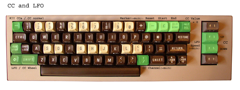

CCs and Values
On the right side of screen the adjustable CC and CC Values are shown. The pointer char “>” infront of Midi-Channel presents the current Channel for a choosen CCs. SHIFT_R + ? switches the CC pointer between the 2 keyfields. CCs are adjustable with F3 and F5. The Keys COMMODORE and SHIFT_L presents the datawheel of K64. CC Values are sended out by moving CC Value up and down with that keys. INST/DEL Key sets values back to 0.
Triangle LFO
There is an integrated LFO option to automate some functions of the datawheel. The LFO option changes the CC Values in a specific interval up and down. Close to CC Value area, there are 2 marker adjustable. The Startpointer “>” on the left and Endpointer “<” on the right side. The Start marker is adjustable by pushing SHIFT_R + LIRE key - the end marker by SHIFT_R + CLR/HOME. Changes adjust the border for triangle LFO. SHIFT_R + “-” Key resets default marker position (0..127).
To Start the LFO press RUN/STOP. To Stop the LFO press RUN/STOP again. You can influence the flow by controlling CC Values manually, changing end- and start-position and setup Speed Value.
Start Marker:
End Marker:
Speed option
The speed value (default = 1) behind the value number presents the speed of changing CC Values, which are controlled by datawheel or by LFO. Manual changes are constantly double fast as LFO. Pushing SHIFT_R + F3 or SHIFT_R + F5 will change the speed value. Notice, if the speed value is 0 the LFO will be frozen.

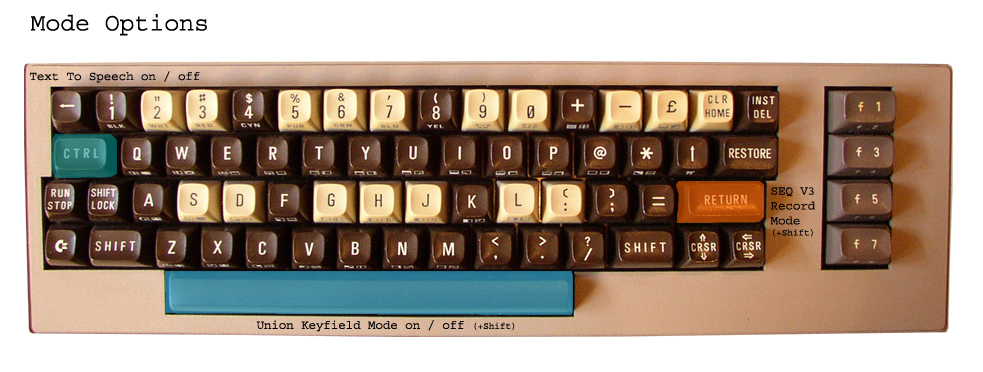

Union Mode
The Union Mode binds the lower and upper Keyfield. All notes will be sended out to the single Midi Channel.

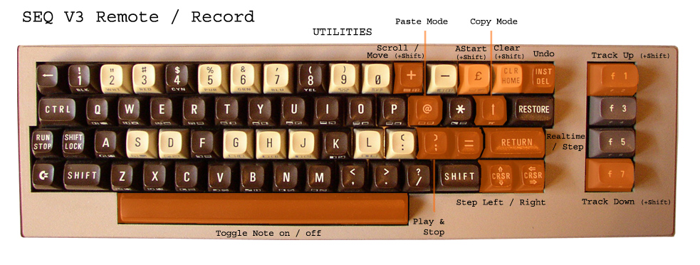

SEQV3 Record
People, which own's a MIDIBox SEQV3 are able to use this special feature to record or to modify parameters as easy as possible from K64. Every step of a track can be controlled by Cursorkeys, toggling notes (Space Key) or recording notes from Keyfield.
The Record Mode is available by pushing SHIFT_R + RETURN in mainscreen. Note!! Only SEQ versions higher than SEQ V3.2a will work correct. All you have to do: Set up the same midichannel for SEQV3 midi-in and K64 (lower) keyfield.
Tracks can be copied by pushing SHIFT_R + UPARROW (Copy) and pasted by pushing SHIFT_R + @ (Paste). Pushing first time will activate the COPY / PASTE MODE (so you can use the rotary encoder of your SEQ to select an area); Pushing same keys a second time again - the selected area will be copied or pasted. Try it out.
For choosing another track you have to push SHIFT_R + F1 / SHIFT_R + F7 for step tracks up or down. If you want to choose one of the 3 layer push SHIFT_R + F3 / SHIFT_R + F5.
Keys like + or SHIFT_R + “+” will activate the SCROLL or MOVE MODE.
CLR/HOME will clear a track; INST/DEL will undo a command.
It's possible to start and stop the sequencer with “]” and “=”.
RETURN will toggle between REALTIME and STEP feature of record mode. I've used the STEP MODE for recording a note at current position, while a track is playing. So now it's possible to listen up the track.
LIRE Key toggles between the AutoStart feature of record mode.

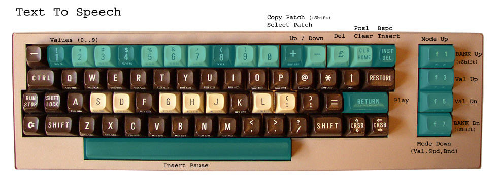

How to create TextToSpeech Patches?
First we changed from mainscreen to TTS Screen by pushing CTRL. Now the first patch will be shown. If nothing is stored before, only a blinking cursor will be displayed. Now you can write a word or a sentence. Notice that the application is preconfigurated for german language (because german words are easier pronounceable from text as any other language. E.g. english are very different between written letters and spoken text - many algorithmics have to be implemented to meet all requirements for a TTS).
Ok, we will try to write a german sentence:
Der Weltraum example
The upper line is for writing input (max. 32 characters for patches are allowed). A space character will insert a pause. The cursor can be moved by CRSR Keys to a special position in word. On the left side you can choose the current bankstick (SHIFT_R + F1 / SHIFT_R + F7) and the current patchnumber (+ / -). The lower line represents different configurations for every letter.
Text modifications
LIRE - delete
INST/DEL - backspace
SHIFT_R + INST/DEL - insert
CLR/HOME - Pos1
SHIFT_R + CLR/HOME - Clear
RETURN key or any MIDI-IN Notes at Channel 13 or Channel 14 (bended) will send out the phrase. Midi-IN Channels 1..12 are used to activate the text patches of bankstick.

Keys
A visualisation of several main areas:
The whole keymap:
—————- Keyboard Mode —————————————————————————————————————–
	<--			select K II CC Mode
	SHIFT_R + <--		Reset SpeakJet
	CTRL			stop current playing notes
				otherwise select TTS Mode
	Z..?			note Ch1
	S..[			halfnote Ch1
	Q..UPARROW		note Ch2
	2..0			halfnote Ch2
	RETURN			activates/deactivates Upper keyfield Hold-Notes mode (+)
	SHIFT_R + RET.		activates/deactivates SEQV3 Record mode
	SHIFT_R + SPC.		activates/deactivates Union mode (for non-splitted keyfield)
	SHIFT_R + =		activates/deactivates Talk mode for lower keyfield (*)
	SPACE			short time - transpose up for Ch2
				long  time - transpose down for Ch2
	COMMODORE		CC Value down
	SHIFT_L			CC Value up
	RUN/STOP		Start LFO / Stop LFO
	CLR/HOME		Reset CC Value (CC Value = 0)
	SHIFT_R + INST/DEL	Set LFO END mark
	SHIFT_R + LIRE		Set LFO START mark
	SHIFT_R + -		Reset LFO marks
	CRSR_LR			Ch1 up
	CRSR_UD			Ch1 down
	SHIFT_R + CRSR_LR	Ch2 up
	SHIFT_R + CRSR_UD	Ch2 down
	F1			Transpose1 up
	F7			Transpose1 down
	SHIFT_R + F1		Transpose2 up
	SHIFT_R + F7		Transpose2 down
	F3			CC up	(KII CC up)
	F5			CC down	(KII CC down)
	SHIFT_R + F3		Increment LFO Speed
	SHIFT_R + F5		Decrement LFO Speed (If Speed 0 - LFO will hold)
	SHIFT_R + ?		Select CC outgoing Channel

	SHIFT_R + RET.		deactivates SEQV3 Record mode
	CRSR_LR	SEQ 		Step Right
	CRSR_UD	SEQ 		Step Left
	SHIFT_R + F1		SEQ Track up
	SHIFT_R + F7		SEQ Track down
	]			PLAY
	=			STOP
	RETURN			REALTIME / STEP MODE
	SHIFT + LIRE		ASTART ON / OFF
	SHIFT + UPARR.		COPY MODE ON (pushing again will COPY from selected area
	SHIFT + @		PASTE MODE ON (pushing again will PASTE to selected area
	SHIFT + "+"		MOVE MODE ON
	"+" 			SCROLL MODE ON
	SHIFT + CLR/HOME	SEQ CLEAR Track
	INST/DEL		SEQ UNDO
	SPACE			TOGGLE NOTE ON/OFF
	(all other note keys will be recorded)
—————- Text to Speech Mode ———————————————————————————————————
	CTRL			select Keyboard Mode
	A..Z			Write Letters
	SPACE			Write Pause (Space)
	RETURN			play/send current speech text
	CLR/HOME		Pos1
	SHIFT_R + CLR/H.	Clear Text
	INST/DEL		Backspace
	SHIFT_R + INST/D.	Insert Space
	LIRE			Delete Letter
	+			Text Patch up
	-			Text Patch down
	SHIFT_R + '+'		Copy Patch to higher patch position (at shift key up)
	SHIFT_R + '-'		Copy Patch to lower patch position (at shift key up)
	F1			MODE up		(VAL, SPD, BND)
