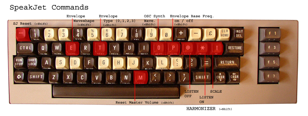

The SpeakJet can be configured with following Keys:
SHIFT_R + E toggle Envelope Type (saw, sin, tri, sqr)
Toggles Envelope Type will only be shown on K2 Display. Parameter E changes to several waveforms.
SHIFT_R + T toggle Envelope State (0,1,2,3)
Toggles Envelope State will only be shown on K2 Display. Parameter T changes to 0,1,2,3.
Bit 1: activates Envelope for OSC 123
Bit 2: activates Envelope for OSC 45
So T = 3 will link all OSCs to the Envelope.
SHIFT_R + O toggle OSC for OSCSynthese
Toggles OSC Waveform for OSCSynthese.
If something goes wrong, or something isn't adjusted right with SJ anymore, it's possible to reset the speakjet with key combination SHIFT_R + ←.
Some more function for configuration the SpeakJet are described on keymap.

	SPEAKJET CONTROL dependend from installed K2 version:
	SHIFT_R + E		toggle Envelope Waveshape (saw, sin, tri, sqr)
	SHIFT_R + T		toggle Envelope OSC State (0,1,2,3)
	SHIFT_R + O		toggle OSC Waveshape for OSCSynthese
	SHIFT_R + P		toggle OSC Envelope Basefreq
	SHIFT_R + M		resets Mastervolume = 127
	SHIFT_R + @		Harmonizer listen key OFF
	SHIFT_R + *		Harmonizer listen key ON
	SHIFT_R + UPARROW	Harmonizer scale (0,1,2)

	F7			MODE down	(VAL, SPD, BND)
	SHIFT_R + F1		BANK up
	SHIFT_R + F7		BANK down
	F3			MODE value up	(0..9)	0 - not displayed
	F5			MODE value down	(0..9)
					VAL:
					0	- Standard LETTER
					1..x	- LETTER Variations
					SPACE VAL (PAUSE)
					0..9	- SHORT...LONG
					SPEED:
					1..9	- SLOW..FAST
					0	- IGNORE
					BEND:
					1..9	- LOW..BRIGHT
					0	- IGNORE
additional K2 MIDI-Implementation-Chart
Please take a look at AC's K2 defination. The only last additional CC's are following:
Function #define default assingment Channel Mode Description
== SYSTEM REALTIME MESSAGES ==
MSA Stop MIDI_CC_ALL_SOUND_OFF CC 120 - STOP MSA / SPEECH
