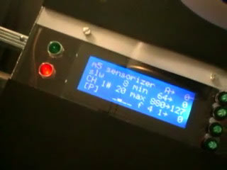

- LCD-Output (2×16 or -recommended- 4×20)

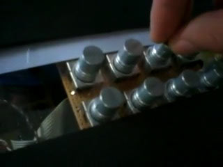

- HUI-Input to control up to 4 sensors with 8 switch-encoders, pedal, store- & panic-button in 2 modes (PLAY/SETUP)

- 1 Mode-Switch button (PLAYMODE ↔ SETUPMODE)
- 8 Encoders with Switch, two Encoders per sensor, the first row of encoders is called ENC_MIN, the lower ENC_MAX
- 4 Buttons (UP, DOWN, STORE, PANIC)
| Function | Encoder(s) | PLAYMODE | SETUP-MODE |
| Turn | ENC_MIN | slowdown factor | scale from |
| Turn | ENC_MAX | send value | scale to |
| Press & Turn | ENC_MIN | CH (MIDI Channel) | senseMin (10bit) |
| Press & Turn | ENC_MAX | CC (MIDI Controller) | senseMax (10bit) |
| Press | ENC_MIN + ENC_MAX | sensor ON | AUTOSENSE_MIN |
| Press | ENC_MAX + ENC_MIN | sensor OFF | AUTOSENSE_MAX |
| Press | PANIC + PEDAL | switch PEDALMODE (Mode 0 to 7) | |
| Press | PANIC + ENC_MAX | switch RELEASE DETECT (ON/OFF) | |
| Press & Turn | PANIC + ENC_MAX | senseFactor (0-32) | - |
Table C: Encoder Controls
