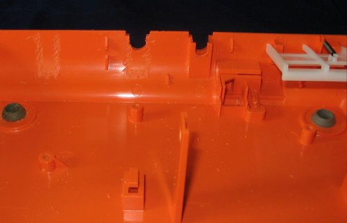

the phone
This is what the phone looks like inside - you can see there's quite some room in there.

First, I milled away most of the mounting posts in the phone:
