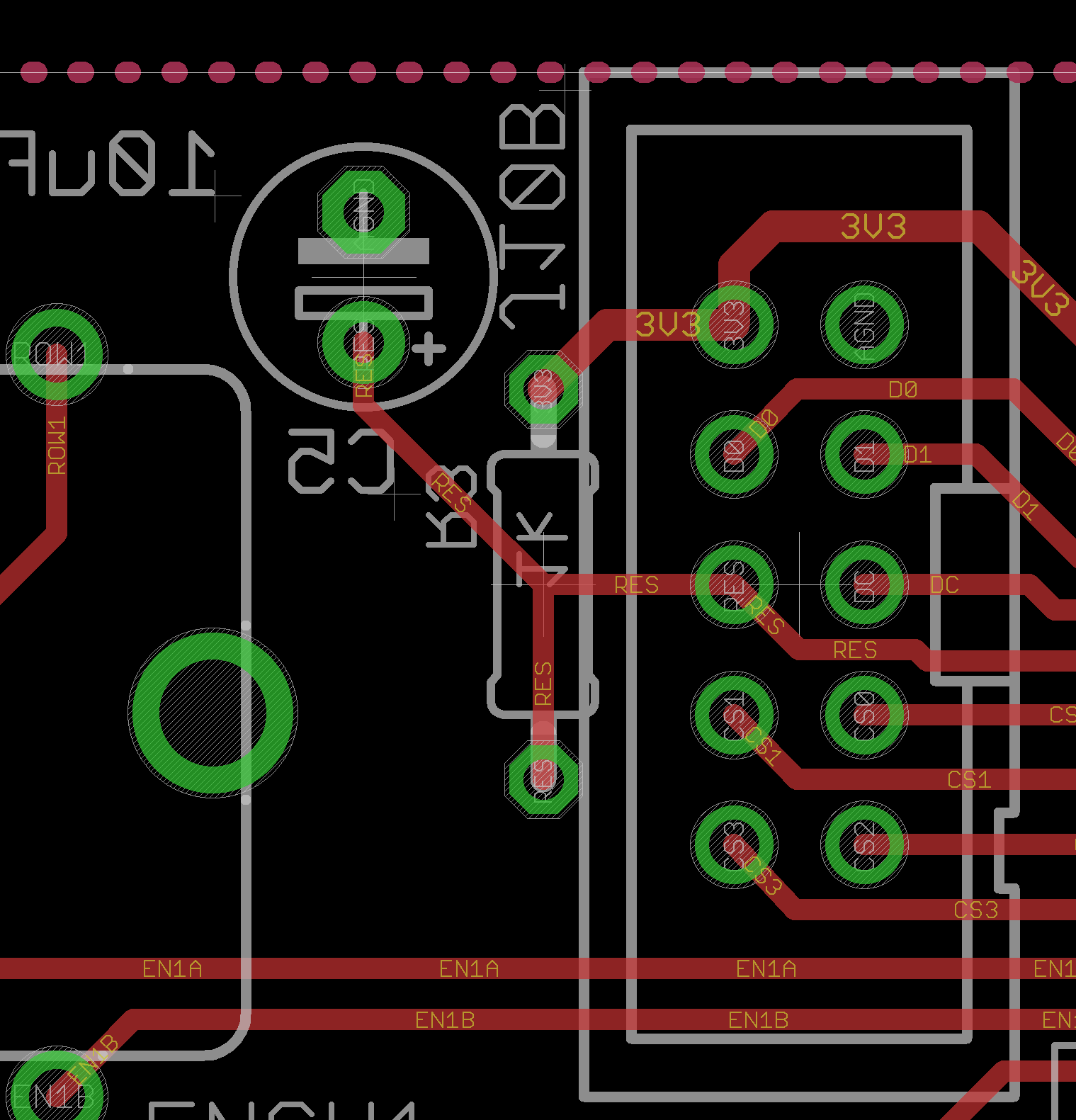

Note that these headers are viewed from the front, so are “mirrored.” Pin 1 is AGND (0V).
J10B: GPIO for typical SSD1306 OLEDs
Note the resistor/cap reset circuit.
J4 carries the WS2812B serial signal. R1 should be 220-470R for only the first module in the chain, thereafter a wire link. J5 is the serial chain output. R2 and C4 could terminate the serial signal but shouldn't be required.
J6 supplies +5V power through a 5817 diode. This is required; there is no power connection to J4.

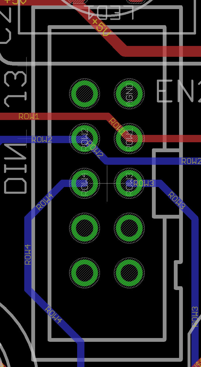

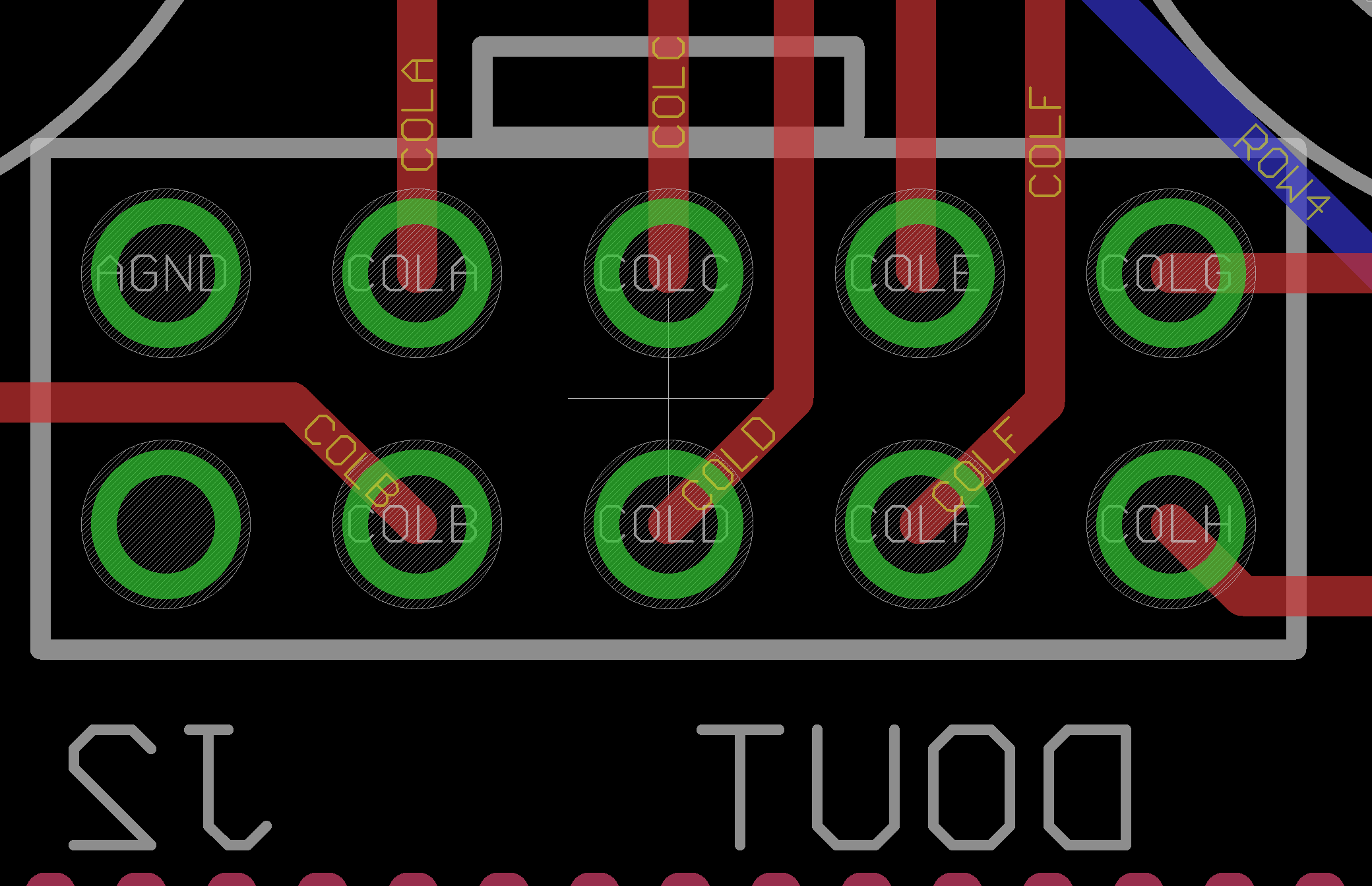

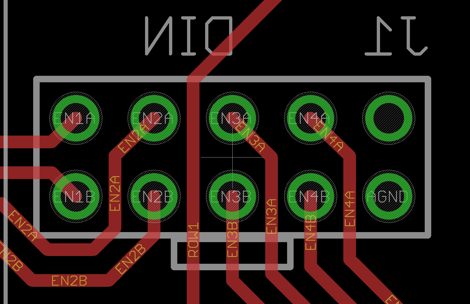

Interconnection to Core
Headers are mentioned above. DIN/DOUT connect to DINX4/DOUTX4 or a DIOMATRIX. J10B to J10B
