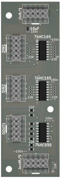

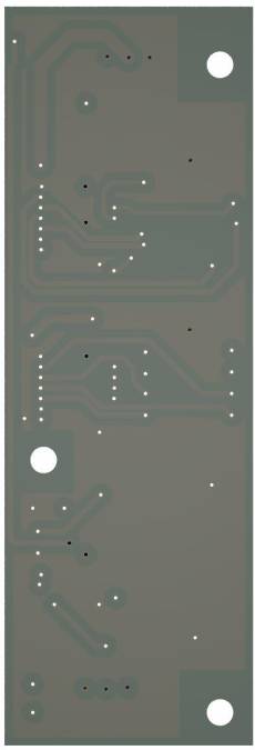

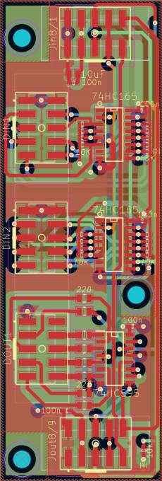

DinX2DoutX1
it gives;
16 Digital Inputs
8 Digital Outputs
The Board is fully SMD, and made for pick and place - so no soldering required!
