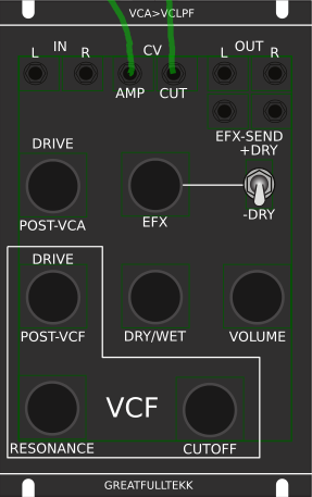

THE VCA and the VCF are controlled with each one CV - each CV has a LFO and a ENVELOPE digitaly mixed… fixed in routing.
basicly a simple VCA (MS20Like) that drives the input of a Audio transformator 1:3 which is a Neutrik NTE10-3 (9€)
this “Tesla” Hi Gain - goes now thru the Post-VCA-Gain-Potentiometer - which then overdrives the 303 Filter (my prototype was a Freebase 383)
sound now goes to the Post-VCF-Gain-Potentiometer
now sound goes into a OP-Amp - to have the change for a light overdrive
From this point a EFX-Send Potentiometer send the Processed Signal to a extra Output (EFX-Send)
With the +DRY-Switch, we switch the orginal Signal additional to this EFX-Send-Potentiometer (or not)
Parallel to the EFX-Send Potentiometer is the DRY/WET Potentiometer it Pan between Orginal and Filtered Sound.
after DRY/WET come the Volume-knob and the Audio outs…
