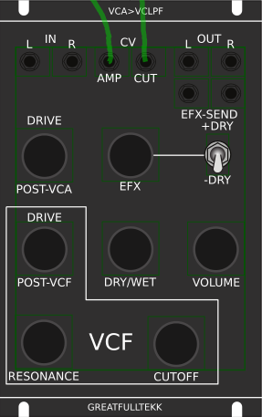

1. Discharged UserInterface for the Brain in “Island mode” (Scopes + Digital-CV-Amount)
2. CV-Breakout EuroModule to be located near the CV-Destination (example: a Filter).

CVś(AOUT):
1.VCF-CUT
2.VCF-RES
3.FILTER DRIVE
4.VCA-ENV
5.VCA-DRIVE
6.DRY-WET (Orginal vs Filtered Mixer)
7.Send 2 EFX1
8.Send 2 EFX2
So 1x 8AOUT-Module for each “Channelstrip”, makes a total of 4x8AOUT-Modules.
The Module of Choise is a 16Bit, since i control with the the same AOUT-Channel ENV+CUT-OFF…
so there is no analog potentiometer for Cutoff or resonance… it is all saved in the Preset.

A not EUROMODULE-BASED Version of something like this is the FILTERBOX:
The panel size is 3U, Eurorack compliant
The Analog Circuits (VCF+VCA) get sandwitch as normal (not90° angeled)
