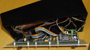

List of parts
  • 1x MBHP Core Module
  • 1x MBHP Bankstick Module
  • 1x MBHP DIN Module (just 3 SR IC's will be used)
  • 1x MBHP DOUT Module (just 3 SR IC's will be used)
  • Labor board with rows for buttons board & bankstick
  • Power input jack
  • 2 MIDI-jacks for MIDI-in and MIDI-out
  • Litz wire
  • Power-switch with backlight
  • 20 buttons with built-in LED's
  • Housing
  • 7-10V Power supply (AC or DC), > 700mA

Connections
Connect the buttons / LED's to DIN and DOUT module like shown in the following table:
Button / LED button to MBHP LED to MBHP
PresetDIN J3 (SR 1) D0 DOUT J3 (SR 1) D7
BusDIN J3 (SR 1) D1DOUT J3 (SR 1) D6
InputDIN J3 (SR 1) D2DOUT J3 (SR 1) D5
OutputDIN J3 (SR 1) D3DOUT J3 (SR 1) D4
Value 1DIN J4 (SR 2) D0DOUT J4 (SR 2) D7
Value 2DIN J4 (SR 2) D1DOUT J4 (SR 2) D6
Value 3DIN J4 (SR 2) D2DOUT J4 (SR 2) D5
Value 4DIN J4 (SR 2) D3DOUT J4 (SR 2) D4
Value 5DIN J4 (SR 2) D4DOUT J4 (SR 2) D3
Value 6DIN J4 (SR 2) D5DOUT J4 (SR 2) D2
Value 7DIN J4 (SR 2) D6DOUT J4 (SR 2) D1
Value 8DIN J4 (SR 2) D7DOUT J4 (SR 2) D0
Value 9DIN J5 (SR 3) D0DOUT J5 (SR 3) D7
Value 10DIN J5 (SR 3) D1DOUT J5 (SR 3) D6
Value 11DIN J5 (SR 3) D2DOUT J5 (SR 3) D5
Value 12DIN J5 (SR 3) D3DOUT J5 (SR 3) D4
Value 13DIN J5 (SR 3) D4DOUT J5 (SR 3) D3
Value 14DIN J5 (SR 3) D5DOUT J5 (SR 3) D2
Value 15DIN J5 (SR 3) D6DOUT J5 (SR 3) D1
Value 16DIN J5 (SR 3) D7DOUT J5 (SR 3) D0
Other connections
power supply jackpower switch
power switchcore module J1 (not polarized)
power switch backlightCore Module J2 (polarized!)
DIN / DOUT J1Core Module J8 / J9
BankstickCore Module J4
See the MBHP documentation to learn how to exactly connect DIN/DOUT/Bankstick to the core module.
