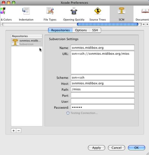

click on the menu items SCM → Configure Repositories
Enter in the information for the midibox svn repository exactly as shown here. But don't click apply just yet.
UPDATE: the URL should now read “svn+ssh:svn@midibox.org/mios”.**

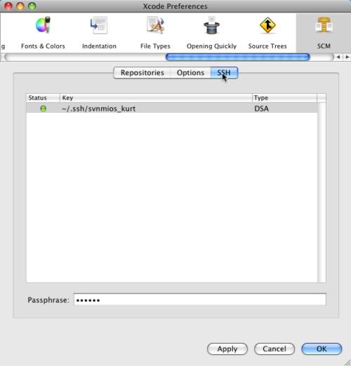

xcoderepauth.jpg —- Select the SSH tab and make sure that your svnmioskey file is listed there. If it's not, restart Xcode. Enter your passphrase.
xcodesshkey.jpg —- Select the Repository tab and click the apply button. It will show that it's testing the connection.
In a few seconds another dialog will pop up requesting your passphrase (I don't have an image of it yet).

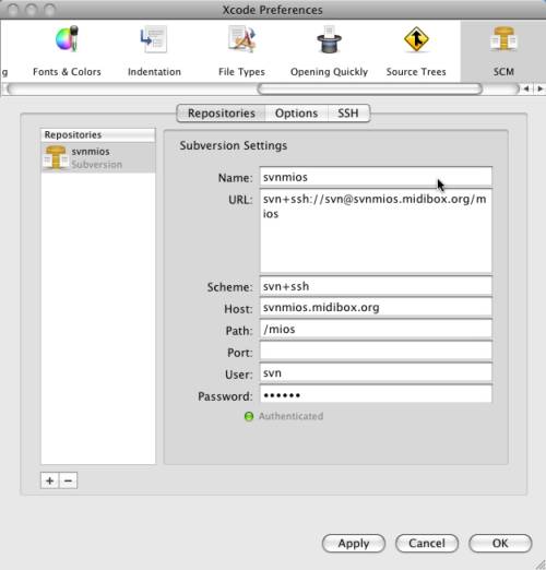

When it's done it will show that it's authenticated.
