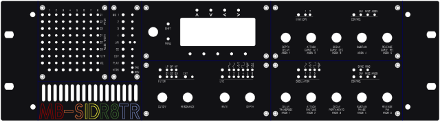

This is the current iteration of the panel, though alternative designs can be found on the forum post relating to this project as well.

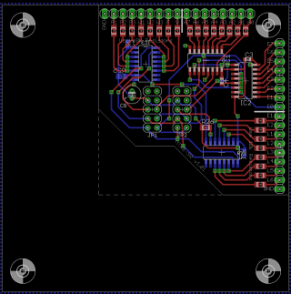

I have designed this a few times and finally settled on using a baseboard that houses the LEDs and buttons, and using a daughtboard to house the shift-registers and things. This should also allow the MB-6582 button matrix via another daughter-card.
A Bulk Order is being organized is you are interested in obtaining your own board at a better price than doing a single board one-off. If you want to know more about the latest happenings, check out this forum post.

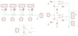

AudioBus
Since I wanted to use external filters and have both a front and rear mixed out, I thought it best to create my own passive mixer board. It combines the passive mixer idea from the MB-6582 with the CMoy amp. I opted to go with the CMoy design because it is easy, effective, and can function both as a headphone and pre-amp.
I am still working on the board design but once it is complete, I will post it here. The board may end up being two boards depending on how bulky it is. I wanted to use PCB mount audio jacks (basically Neutriks from the MB-6582 and Sammich synths) and was planning on using the audio jacks themselves to suspend the board up since I was going to mount my audio jacks probably towards the center of the rear panel (to leave room down below for other boards). I also have not figured out if cable distance is going to be an issue or anything like that.

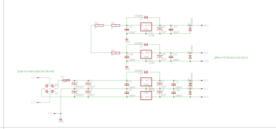

Power
Current Design

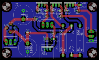

So far I have only done some basic tests of this design, though am pretty happy with it so far. I decided to adopt the newer approach to using a switching DC regulator for the 5V supply similar to the new MB6582 Option E. This can work for both the MB6582 or the SIDR8TR. For the MB6582, it's intended to be used as an external power supply option by supplying +5 and +9VDC directly. And for the SIDR8TR would be part of the power section where where there would also be a transformer. Or so was my idea. The same external power option could be used for the rackmount as well.
You can order the bareboard here from OshPark. Otherwise the EagleCAD files are below:
Previous Design

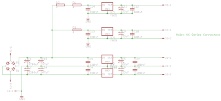

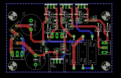

The power board supplies +/- 12V, +9V and +5V. +12V might be able to be used for a SID-6581 but the board is really optimized around suppling +9V (in other words, 8580/6852 SIDs). This board is based off northernlightx's Complete PSU with a few modifications. The +/- 12V is for adding AOUT modules (namely for SSM 2044 filters). NOTE Be sure to use at least one fuse! Putting one on for the main supply before going to the transformer is a very very good idea!
As an alternative, there is a wonderful discussion on the forums about using a modern switching the supply. The idea being that modern switching supplies switch at a frequency far higher than most practical uses of the SID (particularly when given it's noise floor). I have not made up my mind about it yet, however, because the supply discussed switches at 132kHz, which is out of the range of human hearing, but not out of the range of some modern samplers. The only time that I can think would be of significance is when sampling at a grossly high rate (such as 192kHz) and manipulating the audio enough to lower the noise floor to audible levels (say by slowing the audio down, and thus the sampling rate, to a large amount).
That's a pretty pathological case so, for all intents and purposes, the Mean Well supplies mentioned on the forum post (such as this) should be well suitable for the SIDR8TR. I have not decided on what I am going to do yet since the switching supplies are smaller, though linear supplies are more fun :) I think I will compromise and go with a switching supply but use some additional filtering caps, most notably tantalum and perhaps ceramic caps. I don't have a way of testing how much they attenuate the noise but poking around online does show that tantalum caps seem like they would do the trick. I was mostly thinking of adding them as peace of mind :)

| Part | Description | Allied Part No |
| C1 | 4700uF Electrolytic Capacitor | 613-0203 |
| C2 | 2200uF Electrolytic Capacitor | 613-0201 |
| C3, C4 | 47uF Electrolytic Capacitor | 613-0112 |
| C5, C6, C11, C14 | 330nF Ceramic Capacitor | 507-0238 |
| C7, C8, C12, C15 | 22uF Electrolytic Capacitor | 613-0712 |
| C9, C10, C13, C16 | 100nF Ceramic Capacitor | 507-0211 |
| R1, R2, R3 | 4 Ohm, 5 Watt Power Resistor | 296-5275 |
| IC1 | 7812 Voltage Regulator | 568-0489 |
| IC2 | 7912 Voltage Regulator | 935-3055 |
| IC3 | 7809 Voltage Regulator | 568-0960 |
| IC4 | 7805 Voltage Regulator | 568-0488 |
| B1 | Rectifier (1.5A) | 935-6268 |
| X1, X2, X3 | KK-156 Molex Headers | 863-0328 |
| 9x | Crimp Pins | 863-0435 |
| 3x | Pin housing | 863-0414 |
| 1-4x | TO-220 Heatsink | 619-0127 |
| Transformer | 24VCT / 50VA | 967-7285 |
| Crimp Connectors | (For Transformer | ?? |
| Fuse Holder | Radio Shack |

Panel design is nearing completion, though there are a few ideas I still need to try such as some of the ones in this post. From that same post, I learned that using set screws on the back of the panel can be used to secure the panel for some of the additional screws I was going to add to the CS boards for rigidity. That means I need to go with at least a 3mm panel though, so I may need to put in a cut-out for the LCD panel on the back.
