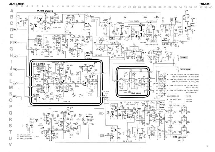

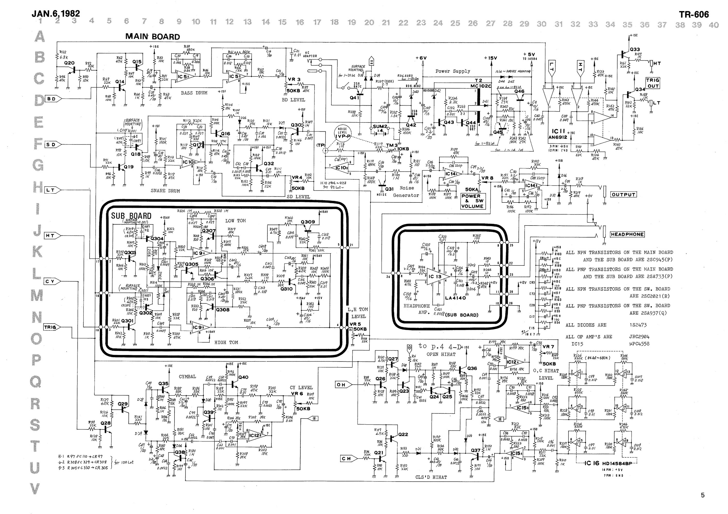

Original Schematics 303
FIXME change against 303
