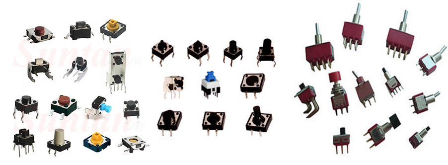

Some Refs?
There is thousands of switches, describing them here would be impossible.
You should have a look to Switch Choosing Guide

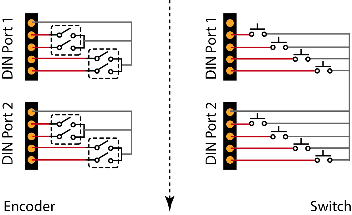

Connection

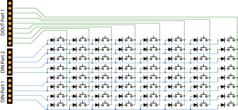

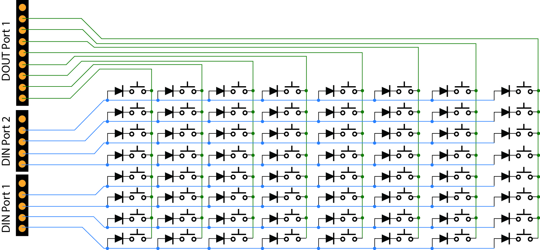

Matrix Design
