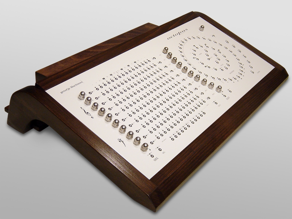

Octopus
From the documentation on the genoQs web site, this appears to be the mother of all matrix pattern sequencers (with a price tag to prove it). Posted here primarily due to its pure beauty!
