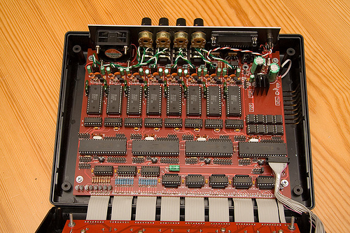

MB-6582 is the name of my MIDIbox SID Synthesizer V2 project.

The prototype base PCB was built for my needs, and my eight 6582 SIDs, so it only generates a 9 volt supply for the SIDs. I did consider generating both 9v and 12v (to support 6581 SIDs also), but there wasn't the space. Plus, this is the MB-6582, it will only ever have 6582 SIDs. So the biggest change to the base PCB is supporting all kinds of SIDs by optionally generating both 9v and 12v supplies. Since the base PCB was designed and the prototype made before TK finalized the hardware design, some changes were made when TK changed the hardware design. With the use of PIC18F4685, the IIC MIDI modules were redundant and removed, the CAN bus required and added, and all PICs were connected to the MIDI In port.

Questions and Answers About The MB-6582 Base PCB
Until I find a better place for this info, I'll put it here…
What is the function of J11 (directly below U1_Core1)?
J11 (not J11_CORE1) is a 4×2 pin header which controls which Core (PIC Tx pin) is connected to the MIDI Out port. You would only need to use this once for the first upload of MIOS and the MB-SID V2 firmware, thereafter connect the master PIC (1) to the MIDI out and after uploading new MB-SID V2 firmware, the master PIC can clone itself to the other PICs across the CAN bus. NOTE: All Cores (PIC Rx pin) are connected to the MIDI In port. The different device ID (0,1,2,3) on each PIC determines which PIC receives an upload, J11 is used to get “feedback” from that PIC during the upload.
What is the function of P1 (extreme lower right corner)?
LCD backlight brightness control, just like on the Core module.
How are the attentuating pots pictured on the rear of the chassis connected?
These are not volume controls. These are for using feedback to get the SID to have distortion, or with Filter Ext In turned on, extra resonance when using band-pass, or LP+BP or HP+BP. They are dual-gang pots, connected to J3_SIDx and J23_SIDx. Input goes to wiper pin (middle pin). Ground goes to left pin (facing towards pot shaft, pins pointing down). Output goes to right pin (facing towards pot shaft, pins pointing down).
What sorts of heatsinks should be fitted for V3 and V1 (I am using Option B). Their positions seem to prevent both from having a sink at the same time. Should I look for flatter heatsinks?
Heatsinks may not be required, it all depends on how many SIDs you use and the load on the 9v and 12v supplies. But if you discover your regulators are getting hot, then you can add heatsinks.
I used these ones as a guide for placing the regulators far enough apart, giving enough space for both to be fitted. http://www.altronics.com.au/index.asp?area=item&id=H0640
Do not connect V1 and V2 to the same heatsink. Do not connect V1 and V3 to the same heatsink. Their common pins are different, V1's common pin is 9V above the common pins of V2 and V3.
If I'm using the PacTec PT-10 case, do the extra headers on the cores really need to be populated?
It all depends on whether you want to eventually connect analog inputs (pots, joysticks, etc.) or analog outputs (to control external filters) to the expansion port on the rear panel. Obviously some are truly unused and never likely to be used (like the IIC port and DIN/DOUT ports) but I put them all in there for full flexibility and compatibility with the Core module PCB. Basically, if you understand the Core module enough to know they aren't needed, then it's up to you whether to populate them.
I choose to fully populate the PCB so that I don't ever need to solder it again, and it looks better than empty holes on the PCB. I suggest people do the same, for the advantages should you need to troubleshoot, but ultimately you're free to do what you like.
At a minimum I recommend at least populating the J15 headers (for LCD) so you can troubleshoot slave cores easily by connecting an LCD (should things stop working!)
Likewise, do I really need to mount pot P2 for the slave cores?
As above, these are the contrast pots for LCDs so they're only useful for troubleshooting. If you want to save on trim pots, you could short between the middle pin and the left or right pin, this would approximate turning the trimpot fully one way and at least let the LCD display something when connected to slave PICs.
The tiny jumper pads on the solder side beneath the cores have something to do with 8-bit mode for LCDs. How are these supposed to be set?
Connect ribbon cable to the LCD or PLED using all wires, as if you were going to use 8-bit mode on a normal Core module. The four wires you don't need for 4-bit mode are not connected on J15 by default. If you discover your display freezing up after a while (but the synth still works in the background), you can execute a MIOS memory read from MIOS Studio to validate that the display has timed out, most likely due to a bug working in 4-bit mode. To fix this, you can run in 8-bit mode by using two PIC pins from port E to replace the two PIC pins being used by the CAN bus. Solder those jumper pads on the bottom side, run the change device ID app to use custom LCD driver, the custom LCD driver file should already be in the source code of the MB-SID V2 application and compiled in. If you want to run other applications, you'll need to copy that custom LCD driver file into those source directories and rebuild those applications.
Is there any reason why 16-volt 2200uF caps cannot be used instead of 25-volt ones?
For the 5v supply: no. For the 9v AC after the bridge rectifier: not really. I was told once to expect up to 2x the voltage after the rectivier, i.e. if it's 9v AC, choose capacitor to handle 18v DC. It really doesn't go up that high I think, and caps rated to 15v should be enough.
The silkscreen for the diode in each core has a via right in the middle, obscuring the arrow. Which direction is the arrow pointing?
The diode is pointing down. Cathode on the lower pin. Refer to the PCB PDFs for more detail.
What's the purpose of the J70 header?
This is a passive mixed output of the four stereo channels, which you can connect to the small phono jack above the power switch. Totally optional.
This was a late design idea I threw into the prototype, the resistors below each audio socket are used to connect the audio signals together when there is no plug in the switched audio socket, i.e. it will only mix those sockets without plugs. You need to connect it together with insulated wire under the board though…. I didn't want to mess up the ground plane with tracks. To the right of the resistors R70-R77 (below the stereo sockets) are pads, these pads should be connected in two sets of wires, one set connects the pads that are next to R70, R72, R74, R76, the other set connects the pads that are next to R71, R73, R75, R77. (NOTE: R2 boards do not require the wires, there are tracks on the top layer.)
I used 10K resistors there because that's what I've seen before in passive mixer designs, but the output is very attenuated, and I am guessing that you could drop these to 1K or less, as the outputs of the audio buffers after each SID can probably handle that. Someone with more audio electronics (and SID!) knowledge can probably answer that question.
I am troubleshooting my LED's and need that cool utility that makes everything light up
It can be found here: http://midibox.org/forums/index.php?/topic/9669-mb-6582-led-matrix-issue/page__view__findpost__p__77144
