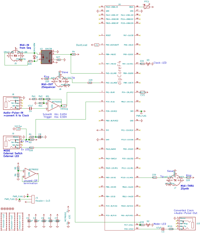

i use a zoom livetrack-l12, a multitrack-audio-recorder: compact design, severell submixes, parametric eqs, compressor, efx and a master-track-recording, a good price…
AND it doesnt have midi… it does not do midiclock.
so when i have to make a track new, or i want to overdub a track, a track that is Midiclock-Driven a sequencer track for example…
So with this device, i lose one Audio-Track, because i use this one Audio-Track, as a Click-Track, it records Audio-Rectangle-Pulses, which are a converted Midiclock-Pulses
when i then playback the Click-Track-Recording, it converts this Audio Pulses back to Midiclock-Messages.
Thats all, not much code, stripped down, running thight.

Shematic

Schmitt-Trigger:
- TS-274 OP-Amp
- 14 Pin - DIP-Socket
- Pin-Header 2x5Pins (to connect the PCB to Core J5A)(you will also need a cable 4 that)
- Resistor R1 20K
- Resistor R2 4K7
- Resistor RFB 100K
- Resistor for Output-Gain-Reduction 100K
- 2x Electrolyt Capacitor 0,67uF (to decouple audio in and out)
- Electrolyt Capacitor 10uF for Supply
- Capacitor 100nF to denoise the OP-Amps-Rails…
- 2 Audio Cables+Sockets for the connection to the Recorder (6,3 mono jacks)
