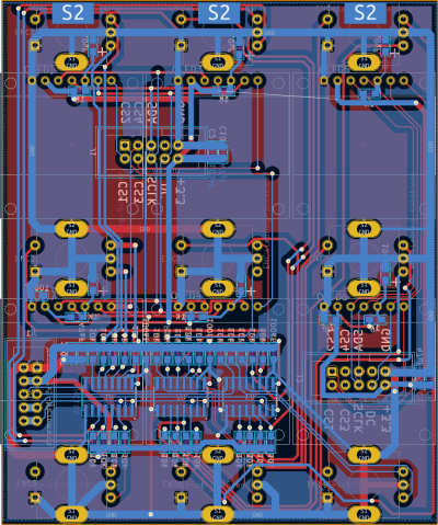

DAW-Encoder-Display - Board

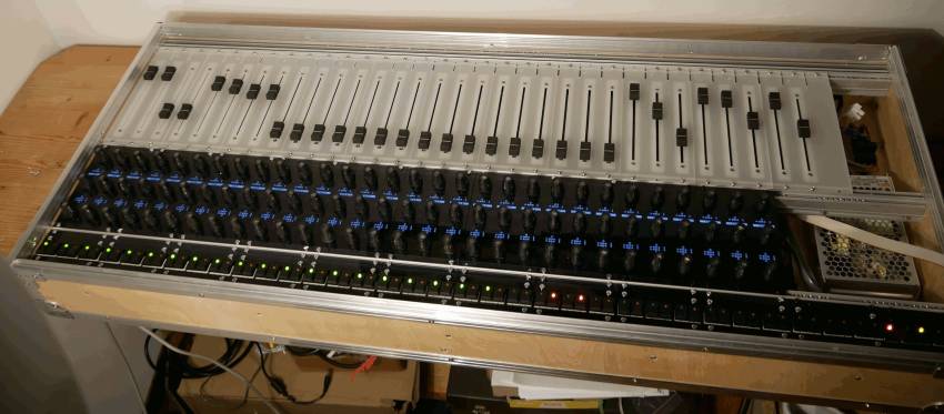

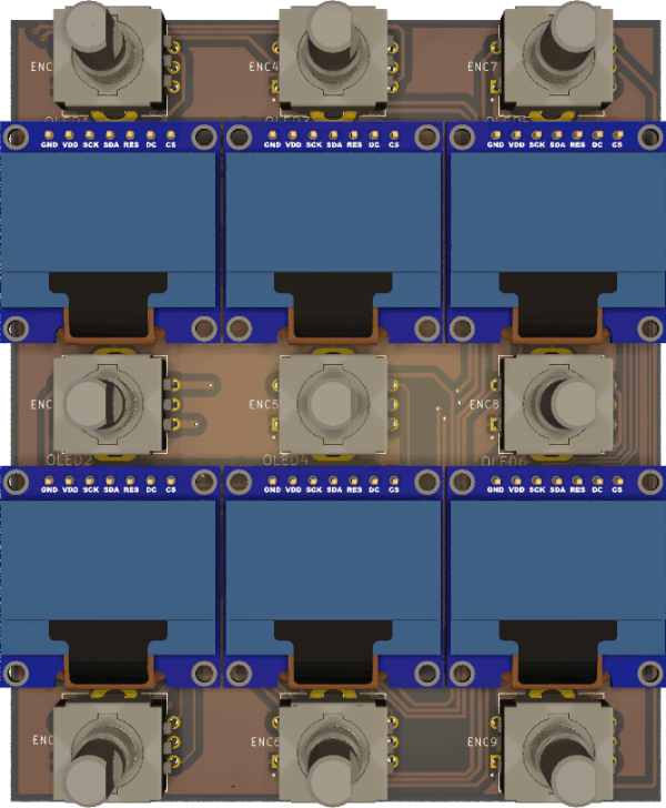

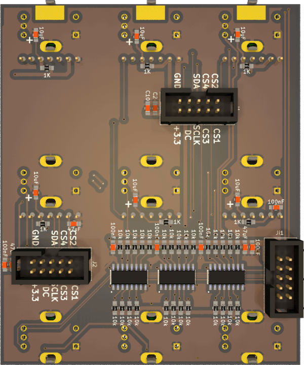

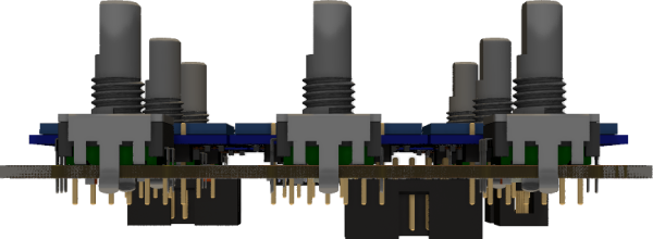

I made this PCBs to use it with Latigid-Ons display_driver
It is one part to build a DAW-controller, it can be used multiple times
Here are the gerberfiles for production - i made it withJLCPCB
daw-encoder-display-gerber.zip
testet - working fine!

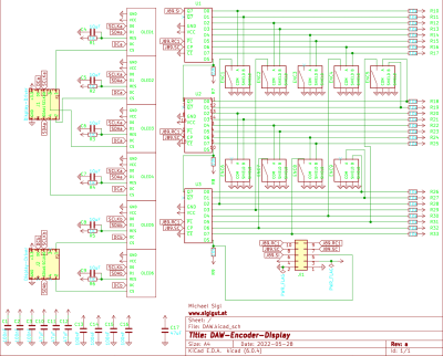

Shematic
Building and BOM
The Values are printet on the PCB.

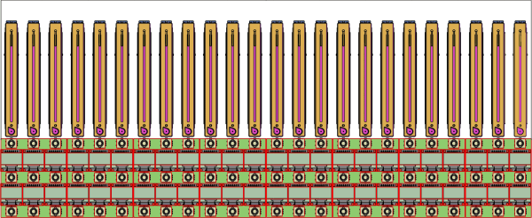

make a Frontpanel.
