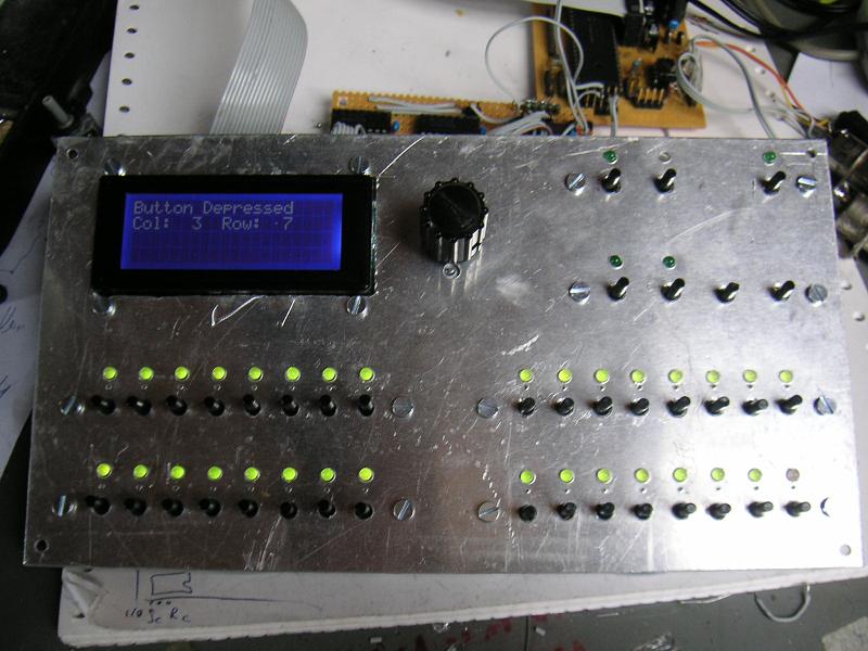

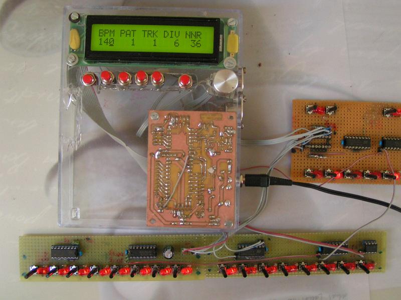

- first prototype
 - new layout design
 - ledmatrix/buttonmatrix finished (see matrix page)
 - frontpanel finished/wired
 - first take on controll surface handler (step, track and pattern handling)
 - sequencer works, timing is not stable yet
 - made a temporary case
 - fixed flickering leds when pushing a button

First prototype:
used for development of data structure, bankstick code, sequencer core

- Construction of frontpanel
 - Wiring of the 32 step leds/buttons
 - Testing of the step buttons with the SM_example application
 - Testing of the step leds with modified SM_example app (modified version includes leddriver)
 - Development of user interface code
 - Button and led handling finished
 - The flickering led problem is solved with MIOS v 1.9c
