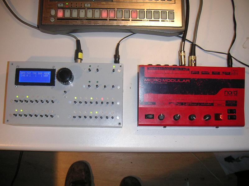

 - ledmatrix/buttonmatrix finished (see matrix page)
 - frontpanel finished/wired
 - first take on controll surface handler (step, track and pattern handling)
 - sequencer works, timing is not stable yet
 - made a temporary case

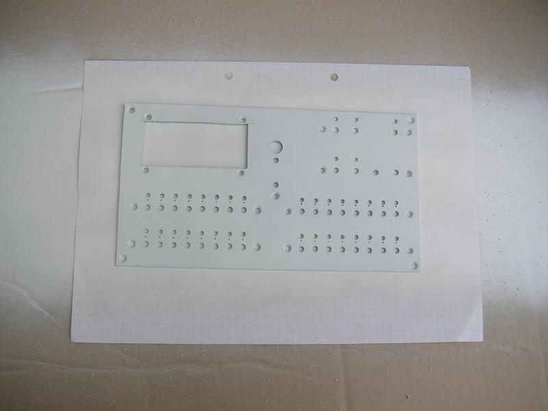

- Construction of frontpanel
 - Wiring of the 32 step leds/buttons
