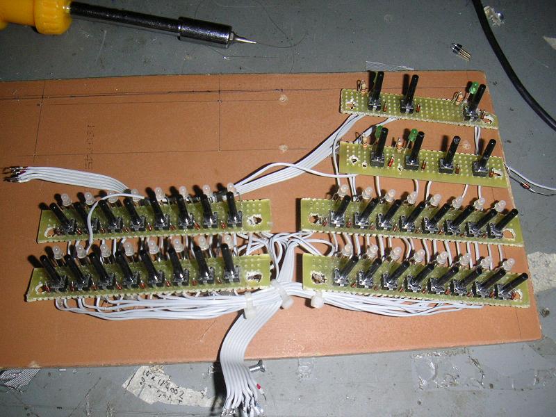

 - ledmatrix/buttonmatrix finished (see matrix page)

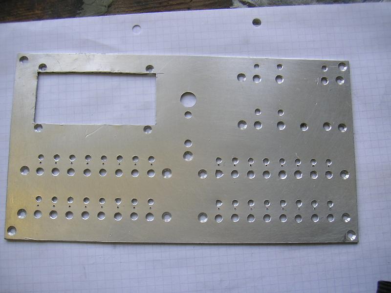

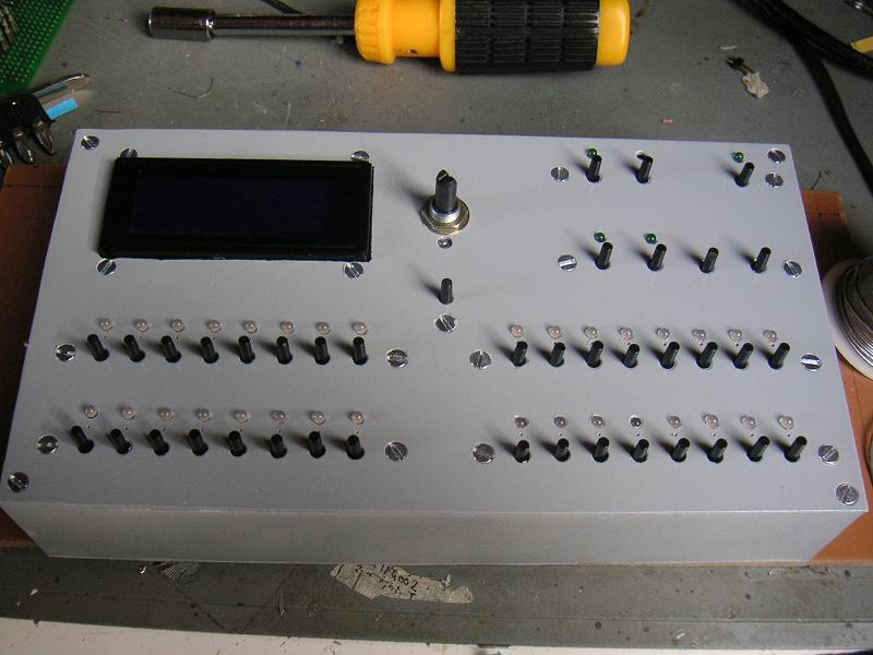

 - frontpanel finished/wired

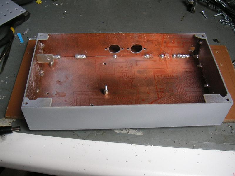

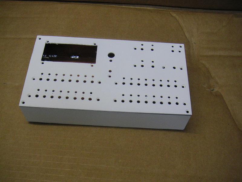

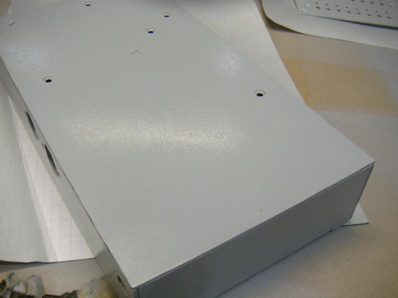

 - made a temporary case

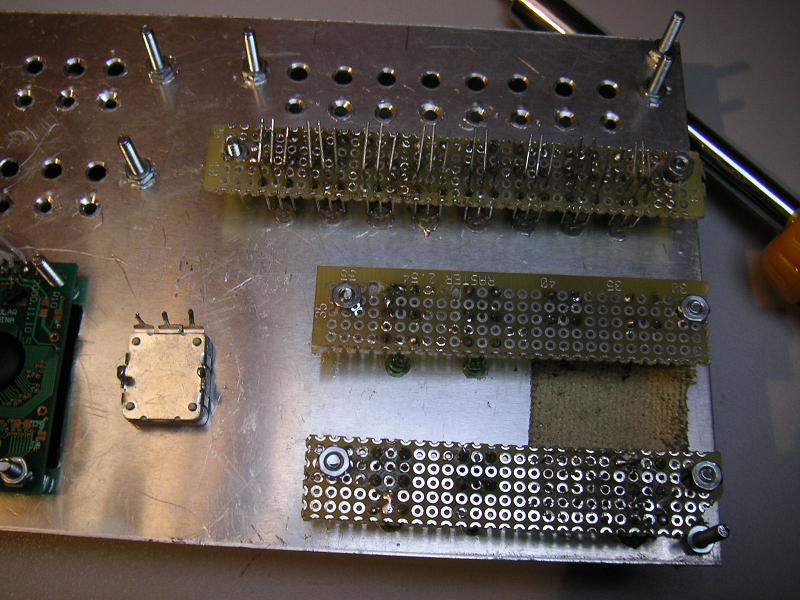

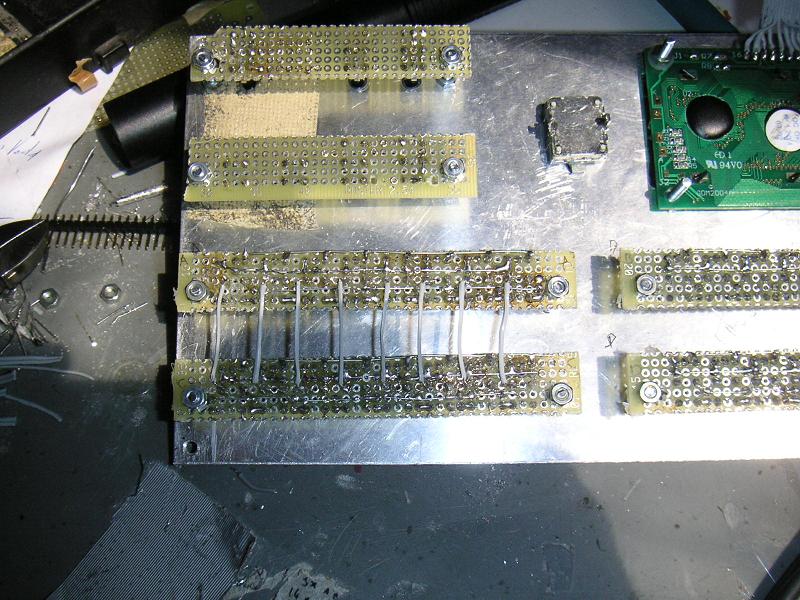

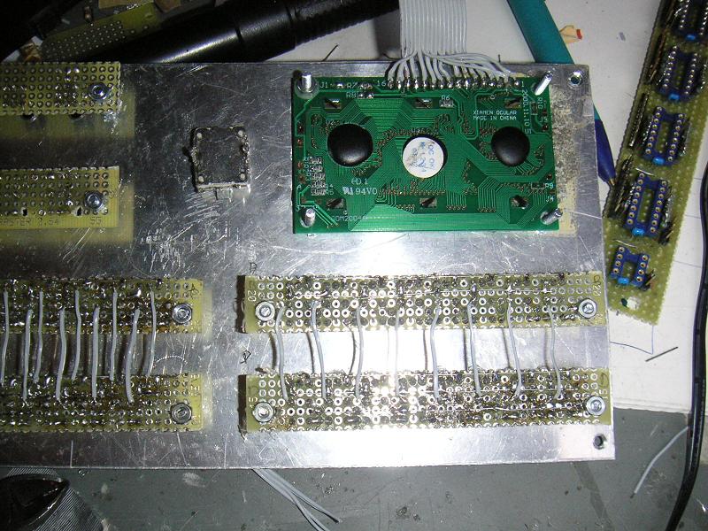

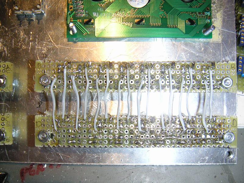

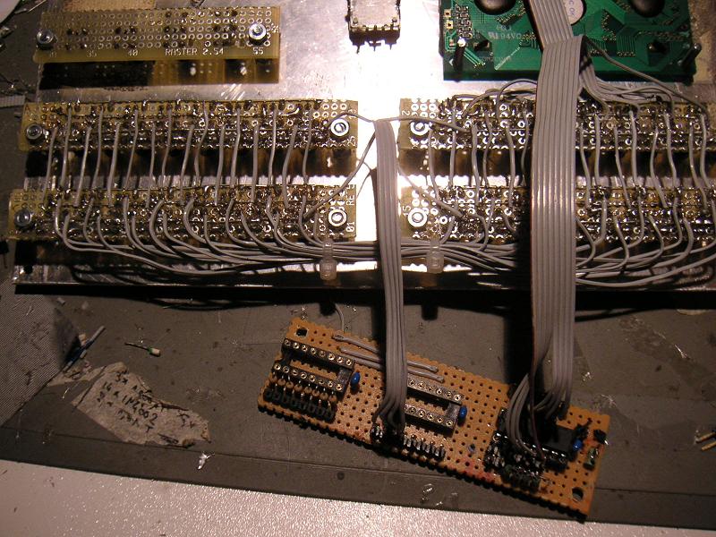

The leds/buttons are wired in a matrix configuration to reduce the number of DIN/DOUT modules needed DSEQ32_matrix

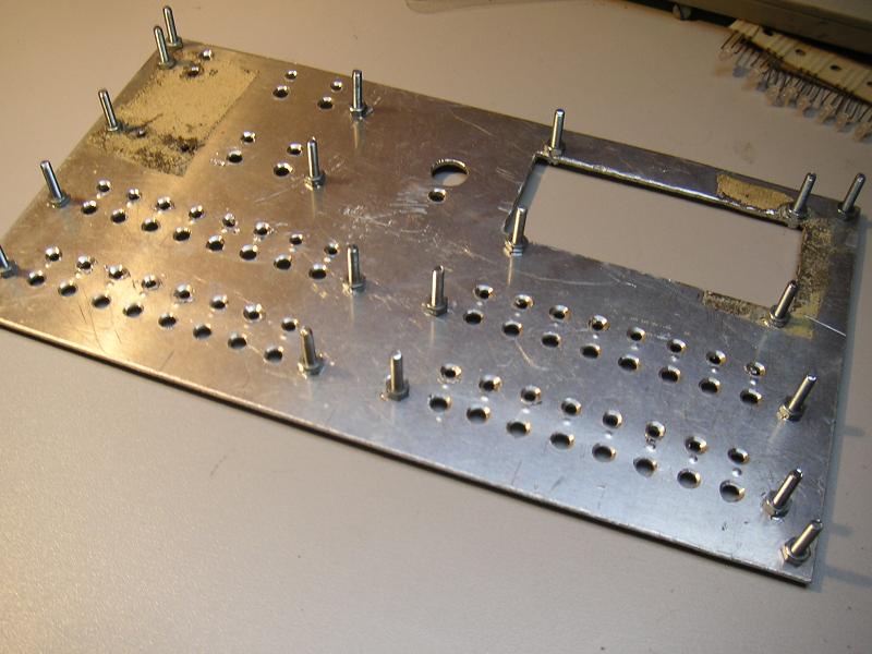

- Construction of frontpanel
 - Wiring of the 32 step leds/buttons
 - Testing of the step buttons with the SM_example application
 - Testing of the step leds with modified SM_example app (modified version includes leddriver)
 - Development of user interface code
 - Button and led handling finished
