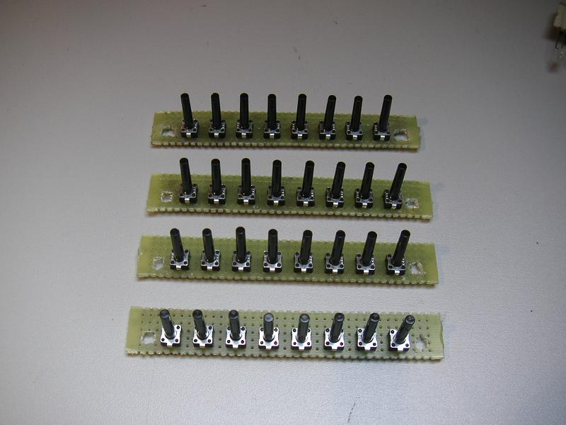

- Construction of frontpanel
 - Wiring of the 32 step leds/buttons
 - Testing of the step buttons with the SM_example application
 - Testing of the step leds with modified SM_example app (modified version includes leddriver)
 - Development of user interface code
 - Button and led handling finished
