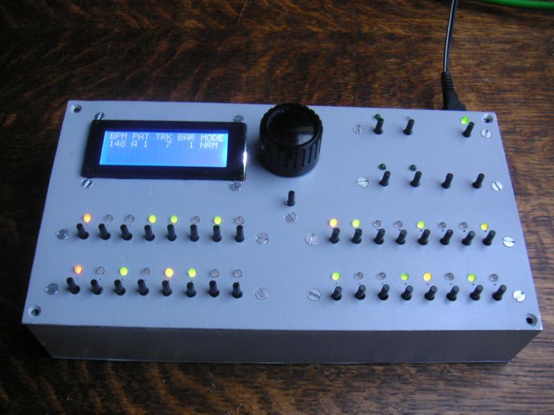

- lcd: displaying (bpm pat trknr edited_par)
 - 32 step buttons + stepleds, leds are dual color to display trig/acc
- step edit behaviour: step off/trig/trig+acc
 - all functions are accessed with a stepkey + shift combination
 - pattern selection: stepkey + pattern button
 - track select/mute: stepkey + track button
- rotary encoder for bpm, also used for editing values

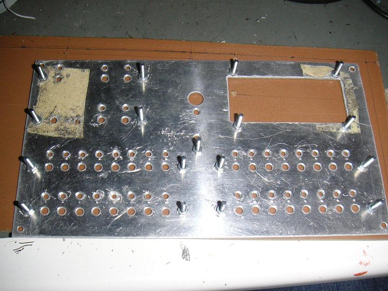

- first prototype
 - new layout design

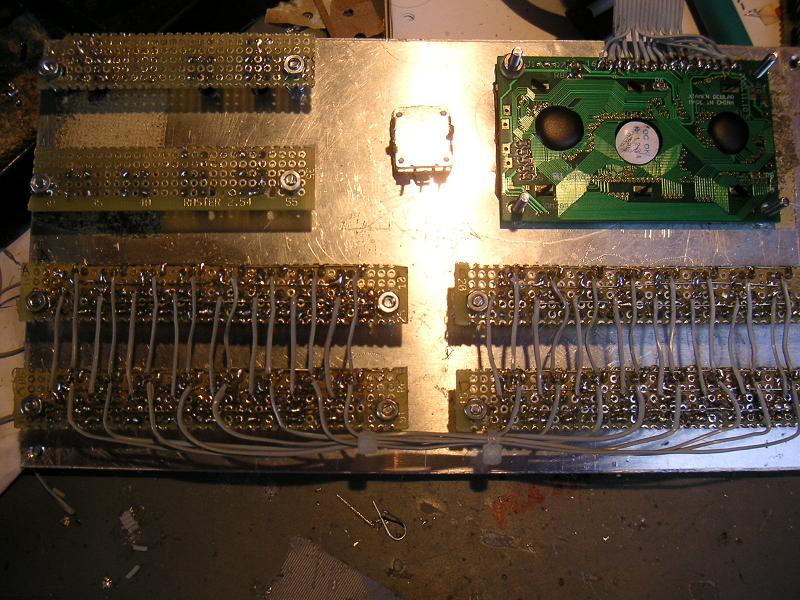

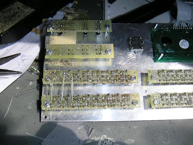

 - ledmatrix/buttonmatrix finished (see matrix page)
 - frontpanel finished/wired
 - first take on controll surface handler (step, track and pattern handling)
 - sequencer works, timing is not stable yet

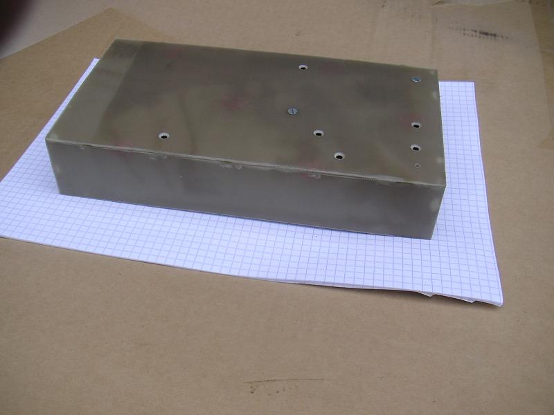

 - made a temporary case
 - fixed flickering leds when pushing a button

New version:
- Construction of frontpanel
 - Wiring of the 32 step leds/buttons
 - Testing of the step buttons with the SM_example application
 - Testing of the step leds with modified SM_example app (modified version includes leddriver)
