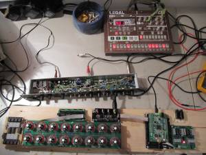

Left-Part of the Brain on Breathboard:
7Segment: LTS547AP
Button: ShadowSE/ITT
3D View of Sandwitches
