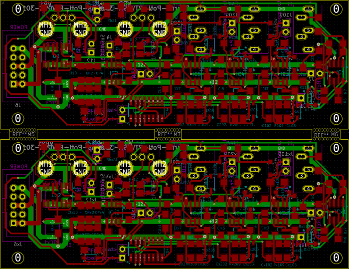

based on Harry Bissel
a SMD Variant, ready for Pick and Place
–shown 2 identical boards on one pcb - to save money..

The Design is optimized for Pick and Place most SMD Parts are on the Top-PCB
i ordered 5 PCBs from JLCPCP with almost all SMD Parts presoldered(except 2 SOIC chips PTC and Protection Diode)

the values with a “x” in it, like Dx1 — are because there are 2 Identical Parts on 1 PCB, because there 2PCBs on 1PCB…. so Dx1 is the same like D1, but its position is on the second board.
