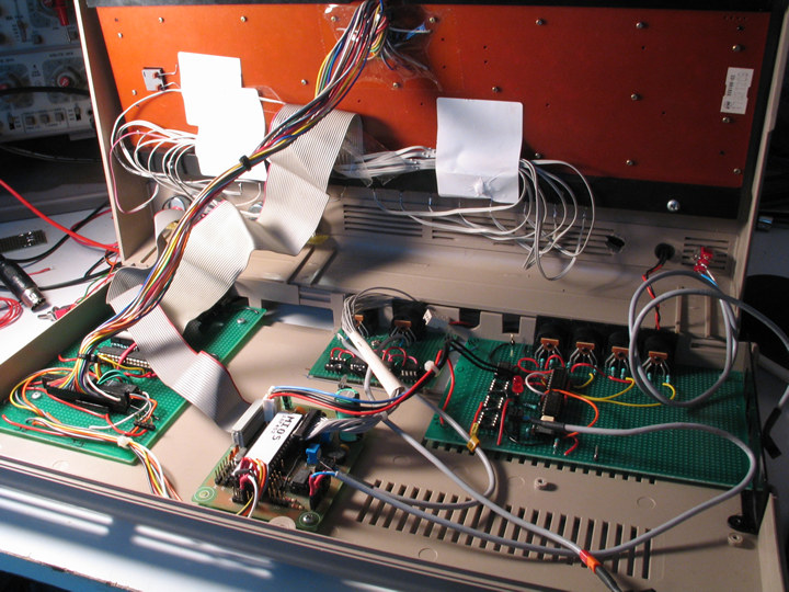

First, i did this pcb (on a breadboard) :
The program

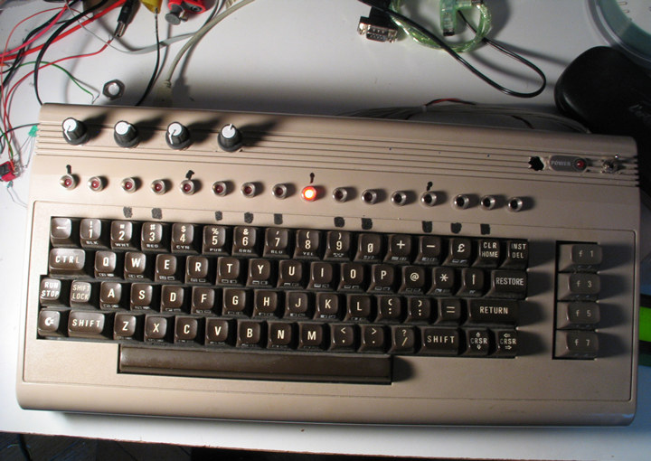

It can look like this
http://www.youtube.com/watch?v=OZGhumzoR70
