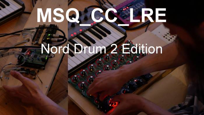

Table of Contents
MSQ-CC-LRE
MotionSeQuencer for ControlChanges for 2xLRE8x2 Boards
Synth-Patch-Editor & Motion-Sequencer 4 ControlChange (= CC-Automation)
Introduction
Controls and automate a Nord Drum2 (Drum-Synth )NORD DRUM 2
It acts as:
- Midi Merger NTE,CLK,PC merge with CC…
- Patch Manager it replaces the Synths internal Patch Storage, each PC Number from your Sequencer is added by the BANK CC (CC 32), where each Nr is ADD 128 PC Numbers more…
- Motion Sequencer Record your Controller Movements in a Sequence in 32th Resultion @ maximal 256 Steps length
Features
