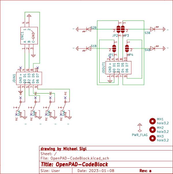

Shematic

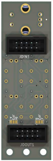

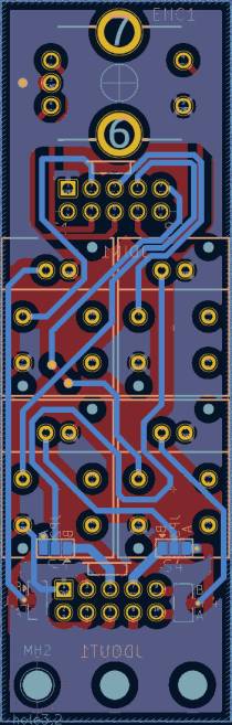

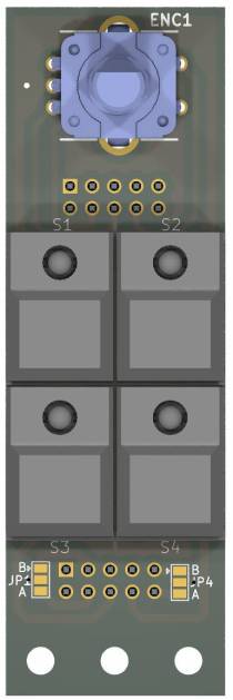

Building and BOM
THT, and handsolder
This PCB is needet 2x for OpenPAD
