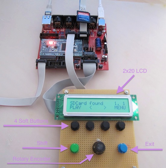

====== Standard Control Surface (SCS) ======= {{ ::neonking:midio128_v3_cs.jpg?direct&4300 |}} ===== Introduction ===== The Standard Control Surface (SCS) allows to edit some (but not all) configuration values without the need of a computer. ===== Description ===== A detented rotary encoder and 6 buttons are directly connected to J10 of the Core module to control the menu system.In addition a LCD is required. The recommended size is at least 2x20! Graphical LCDs (GLCDs) are supported as well. The [[MIDIO128]] project uses the same control surface, which means that users who built a MIDIO128 can upload the MIDIbox NG firmware and control it with their existing hardware, and vice versa! In the main page (which is active after power-on) it's possible to emulate BUTTON and ENC functions, which means that a very basic MIDI controller with a rotary encoder + 6 buttons could be created without the need to attach a MBHP_DIN module to the core! ===== Schematic ===== {{ ::neonking:mbng_scs.jpg?direct&600 |}}
