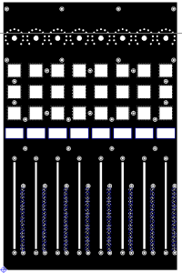

Frontpanel

Make a Frontpanel. - depends on Buttonboard…
