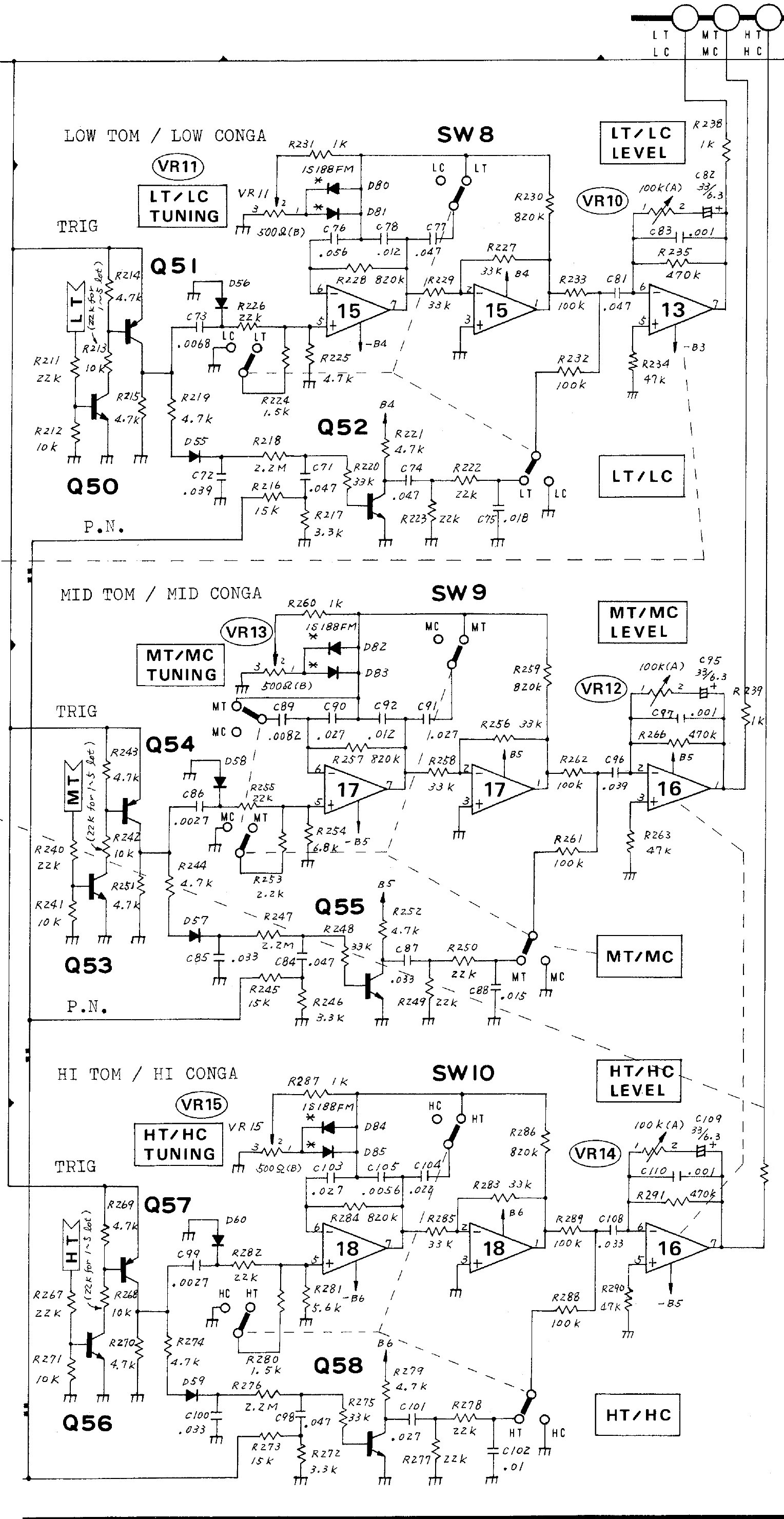

Original Schematics
Global
BD/SD
Toms/Congas
