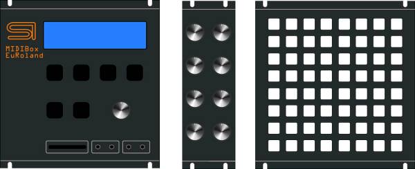

MB-Modulbox Main PCB UI
Access to System-Settings, Channel, NoteNumbers
CV+Trig Out-Jacks for Euroland Drum Modules
MB-Modulbox 8xPotentiometer Module
When using the Euroland Modules via Midi, then there are some Performance Parameters aviable:
All Functions have effect on all 8 Voices @ once.
  • 1.Velocity Offset (-+64 > with Center Postiton = normal)
  • 2.Velocity Kill depending Note Kill (-+64 > with Center Position = normal > Full Spectrum)
  • 3.Random Kill (0=full Kill, 127 no Kill, Normal Position > 127)
  • 4.Velocity 2 TriggerLength (-+64 > with Center Position = normal 10ms, turn right:time inc by velocity in%, turn left:decrease%)
  • 5.Accent: (0-127-normal 127)
  • 6.——: could be something like Roll
  • 7.——: not used, could be something like a Accent for a Group of CVs
  • 8.——: not used, could be something like a Accent for a Group of CVs
accessible via MB-Modulbox 8xPot - PCB. Just plug it in, and acitivate the AIN-Port in MIOS
MB-Modulbox 8x8 LED-Button-Matrix
Set CV + Trig Routing (some kind of trigger matrix), standard is 1:1 routing, so no need for this if you use a fixed setup.
