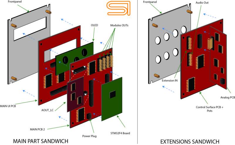

The Midibox EuRoland project aims to be a 4U Re-Edit of Analog Drum Parts of Roland TR Drumachines designed to fit in the Eurorack size Format, to be driven trought MIDI or CV.
It's the Merging of these projects:
Just let a Private message on the forum to users already involved
2 Cases of use :
Access to System-Settings, Channel, NoteNumbers
CV+Trig Out-Jacks for Euroland Drum Modules
When using the Euroland Modules via Midi, then there are some Performance Parameters aviable:
All Functions have effect on all 8 Voices @ once.
accessible via MB-Modulbox 8xPot - PCB. Just plug it in, and acitivate the AIN-Port in MIOS
Set CV + Trig Routing (some kind of trigger matrix), standard is 1:1 routing, so no need for this if you use a fixed setup.
Here are only the Analog-Drum-PCB discussed, since all other Digital UI is based on MB-Modulbox Standart Modules, the MB-Modulbox Main PCB2 is special Variant, described here.
