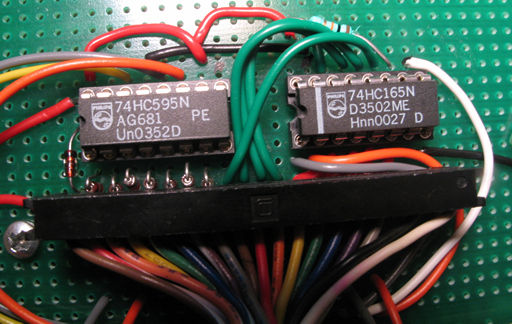

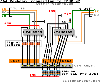

First, i did this pcb (on a breadboard) :
