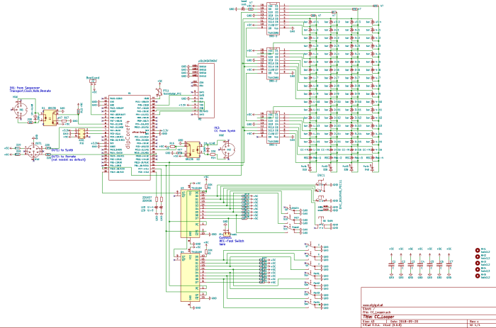

Midibox:
  • dipcoref4 - this is the µC Brain for the Looper
  • cc-looper - this is the UI-PCB of the Looper
  • no other PCBs needet
  • µSD-Card, formated with FAT32
  • Soldering Iron - with a Dip that can Handle SMD-Parts, Wires, solder Paste for the µC….
  • USB Power Supply with µUSB-Connector
Set
Cabeling
Midi IN1 »> MelodySequencer and Remote Devices
Midi IN2 »> Midi Out from Synthesizer - which sends out the Moved CCs
Midi OUT »> Midi IN of Synthesizer input (Automated CCs merged with mididata from Midi IN1)
