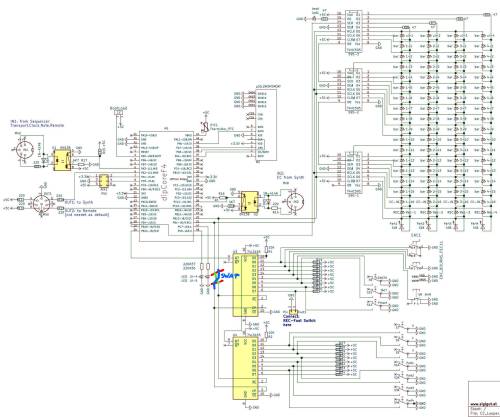

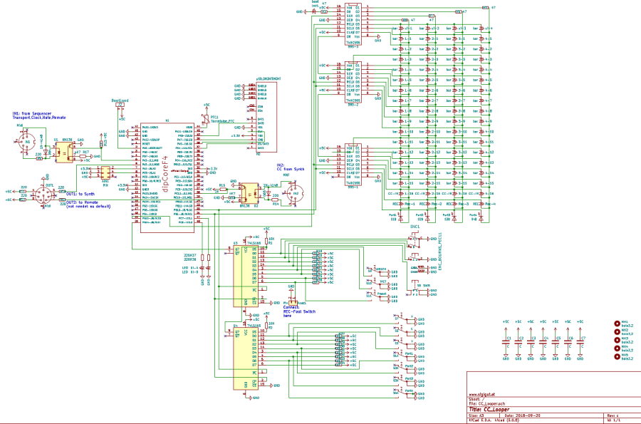

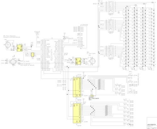

Midi Control Change MotionSequencer - for Synthesizer with LEDRINGS
Features
* 4Midichannels @ each 512Steps X 32th-looprate X 128 CCs
* only a few of the 128CC should be used @ once - 4x128xCCs @ 32th is Midi Data MESS and µC Death
* maybe only 256Steps, will depend on RAM…. RealWorld will tell
* each TRACK has a shared Track length for all its 128 CCs
* Copy, Paste, Clear: for the all 128CCs/or single CC
* There is no EDIT, you can clear a CC or Track and make a new Take
* ProgramChange Load and Store on microSD-Card, Load and Store are CC-Commands, so you can remote the device
* The Sequencer can be set to Tact Systems: 3/4 4/4 5/4 7/4 9/4 11/4 13/4
Hardware Requirements
External Requirement:(for example)
  • You need a Synth with LEDRINGs - otherwise you have no Feedback and Overview - NordRack III is such one
  • Melody/Clock Source with ProgramChange-Output: midibox_seq_v4l oops that dont do PC…
  • Melody/Clock/CC Destination: NordRack III or any other Synth with Visual Feedback off CC-States
Midibox:

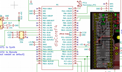

  • dipcoref4 - this is the µC Brain for the Looper
  • cc-looper - this is the UI-PCB of the Looper
  • no other PCBs needet
  • µSD-Card, formated with FAT32
  • Soldering Iron - with a Dip that can Handle SMD-Parts, Wires, solder Paste for the µC….
  • USB Power Supply with µUSB-Connector
Set
Cabeling
Midi IN1 »> MelodySequencer and Remote Devices
Midi IN2 »> Midi Out from Synthesizer - which sends out the Moved CCs
Midi OUT »> Midi IN of Synthesizer input (Automated CCs merged with mididata from Midi IN1)
Software
Firmware
FIXME Firmware not made yet
Building
Frontpanel
FIXME - a clear Acrylic Frontplate, with NO Engravings, UI-Labeling is viewable from PCB
Case
BOM
Ref Qty Value Footprint MouserPart
C1 – C7 7 100nF 0603 Capacitor 81-GRM33C71C104ME14D Mouser
Rec–1 – Rec—4, UI–5 UI—4, led1, -1 -2 -3 -4 11 REC, LED, beat, CC-IN, 0603 LED 630-ASMT-RR45-AQ902 Mouser
1-16 (LED-BAR) 64 bar 0603 LED 755-SMLEN3WBC8W1 Mouser
D64 D65 2 1N-4148 1206 Diode 833-1N4148W-TP Mouser
PTC1 1 Thermistor_PTC 1206 Resistor 576-1206L150THWR Mouser
R1, R2, R19 – R34 18 10K 1206 Resistor 603-AC0603FR-0710KL Mouser
R3 R5 R6 R7 R8 5 47 1206 Resistor 603-RC0603FR-0747RL Mouser
R9-R14, R36, R37 8 220 1206 Resistor 603-RC0603FR-07220RL Mouser
R15 R16 2 1K 1206 Resistor 603-RC0603JR-071KL Mouser
R17 R18 2 4K7 1206 Resistor 603-RC0603FR-074K7L Mouser
OUT1 1 Midi DIN-8-SDF-80J 490-SDF-80J Mouser
M1 1 DIPCORE32_CMPNT_48P517-929870-01-20-RA DIP-40 Mouser
S8 1 Shift DT6 611-D6R00F1LFS Mouser
S1 – S4 1 Part1 611-SERWHAUOA DTL2-1-LED Mouser
S5 – S7, S9 – S10 6 X,C,V,Len,Pre,Tac 611-SERRDAUOA DTL2-1-NO-LED Mouser
ENC1 1 ENC_BOURNS_PEC11 ENC_BOURNS_PEC11+SW 652-PEC11R-4215F-S24 Mouser
IN1 IN2 2 Midi Midi-Socket-MAB5SH-DIN-5566-MAB5SH Mouser
Foot1 1 Pin
J2 1 BootLoad
AIN1 1 PIN
U1 U2 2 6N136 SMDIP-8_W11.48mm 782-6N136-X009 Mouser
-595 3 74HC595 SO-16-N 621-74AHC595S16-13 Mouser
U3 U4 2 74LS165 SO-16-N 595-SN74LS165ADR Mouser
M2 1 µSD_DM3ATDM3AT ΜSD_DM3AT 798-DM3AT-SF-PEJM5 Mouser
