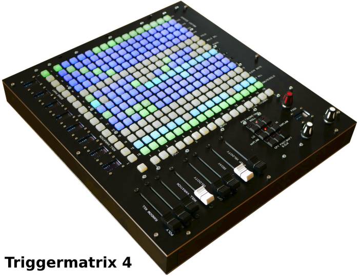

====== Coil Winder ====== **REAL:**\\ {{:phatline:tm4-perspektive-l.hd-.jpg?700|}}\\ \\ ===== CODE, FIRMWARE ===== **Install [[http://www.ucapps.de/mios_studio.html|MIOS Studio]], connect a Core-Stm32F4 via USB, and Start the STUDIO**\\ \\ **1. Upload [[http://www.ucapps.de/mios32/mios32_bootloader_v1_018.zipm|MIOS BOOTLOADER]]**\\ **2. (only needet for Virgin Machines) type following commands into the MIOS-TERMINAL:**\\ * set lcd_type GLCD_SSD1306_ROTATED\\ * set lcd_num_x 2\\ * set lcd_num_y 1\\ * set lcd_width 128\\ * set lcd_height 64\\ * store\\ **3. Unzip {{:phatline:coil-winder.zip|the Firmware}}, and Upload the project.hex**\\ **4. Unconnect USB & Connect the USB again --- finished.**\\ **5. If the Machine is not detected by mios studio, and you already checked the usb-connections, the device or the code is broken, for that you may search for "Bootload Switch", please set it to "bLOAD", now you can upload new & unbroken codes, dont forget to set it to "normal" back again - after upload new code - else the APP will not boot...**\\ ===== BUILD ===== ==== Shemata ==== {{:phatline:Coil-Winder-Shemata.jpg?700|}}\\ ===== Community users working on it ===== * **[[Phatline]]** = Programming, Documentation, Hardware-Prototype, Testing, Winding\\ ===== Getting Involved ? ===== Just let a Private message on the forum to user already involved
