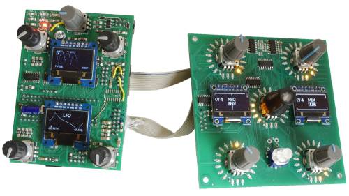

–First Prototyp with a fiew modifications
–this picture is the first prototype - pre-Eurorack :-D very-early-version...k

The Design is optimized for Pick and Place most SMD Parts are on the Top-PCB
i ordered 5 PCBs from JLCPCP with almost all SMD Parts (except 10pF µSD and 4x100nF) presoldered
now waiting for Presoldered PCBs LOL - for 15€ a Piece!
The Resistors for the LEDs are under the top LCD, so test your LED brightnes before soldering the Top-LCD
You can remove LCD later but, it is hard! and you may damage the LCD or the PCB…
