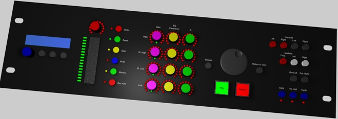

MIDIBox64e w/remote
This is going to be my main daw controller. The main console will have:
- A continous fader (encoder with a belt) w/16 leds
- An encoder for pan w/13 leds
- 12 encoders for EQ w/13 leds
- Jog Wheel
- 32 buttons.
Render of what it might look like

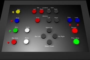

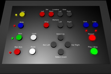

There will also be 2 remote consoles. Featuring:
- 20 buttons
The remote consoles will only have a DINX3 and a DOUTx3 inside.
They will patch into the DIN/DOUT chain via Cat5 at the main console
